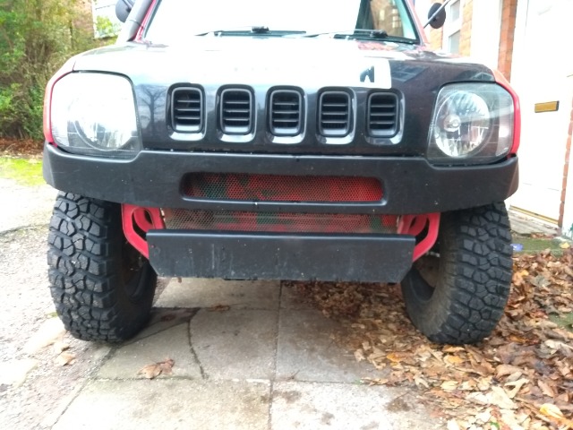

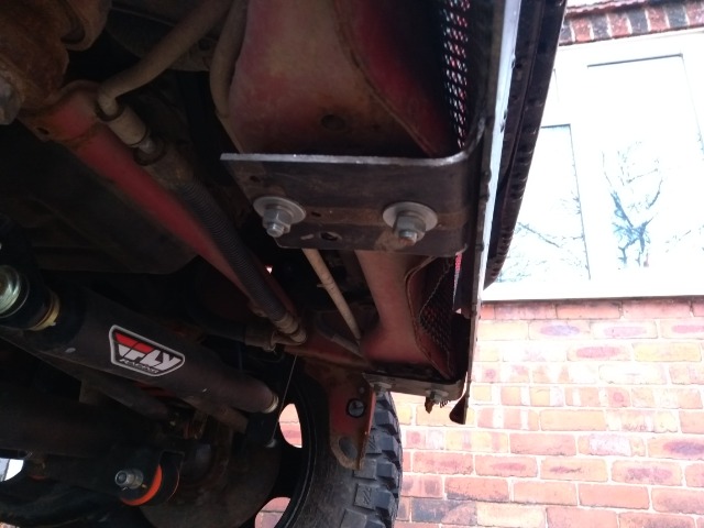

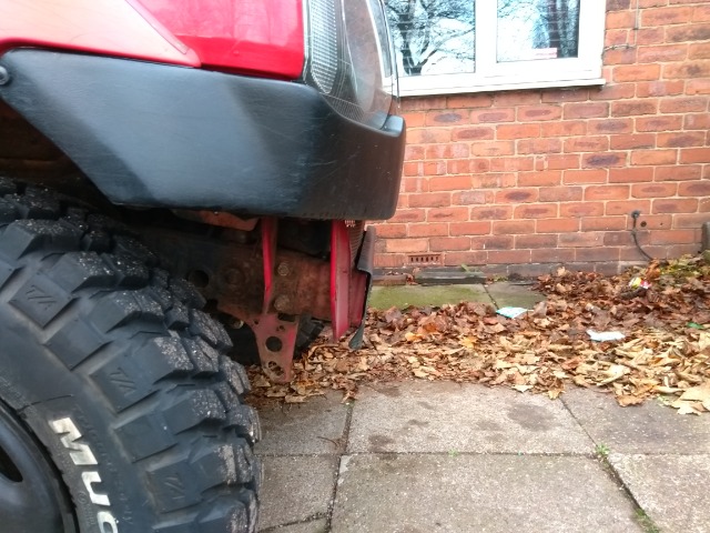

The mesh is flexible HDPE 6.5mm hole size
With bumper mounts cut off
The plate is 3mm aluminium bent cave man style with a hammer and bolts on where the anti roll bar mounted

Thanks Jack, yes its pretty similar but yours is even closer in. Neat with the chassis legs chopped off as well as that plate. Looks ideal.
There will probably be a winchplate going in there so i guess that i will need to keep the chassis ends for that on mine.

chassis ends need to go i'm sorry to say they're weak as piss replace them with 80x40 box section then weld your winch plate on
I have been advised to chop out the front cross member
weld in some box section with a 50mm receiver hitch built into it
Has i want my winch on a removable plate
also a 50mm hitch on the rear

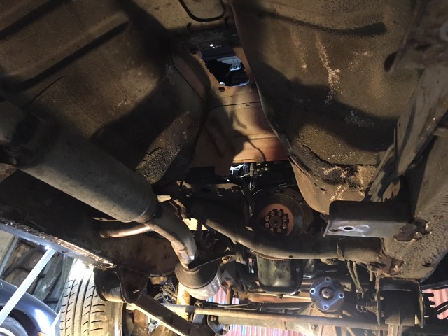

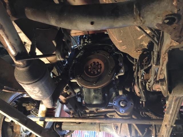

Got a road trip planned on friday around manchester area to pickup and drop off parts for this build. Needed to take the gearbox and t-box out as they are going so up on the ramps and drain the gearbox oil.

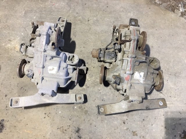

First out was the transfer box. sat next to J999MNY's original one (this one is on the parts run for Sniper).

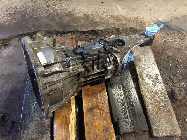

Then an almighty fight and finally the gearbox is out...

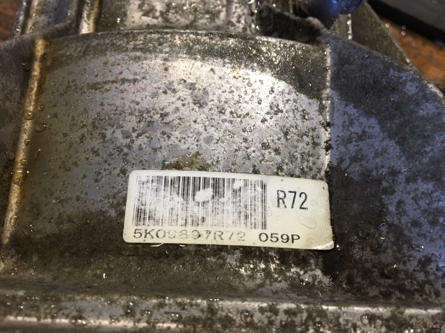

Took some doing but thats now ready for the parts run as well (this one is a swap with James Priestly for an earlier R7me gearbox to suit the rest of it with better ratio's).

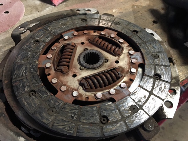

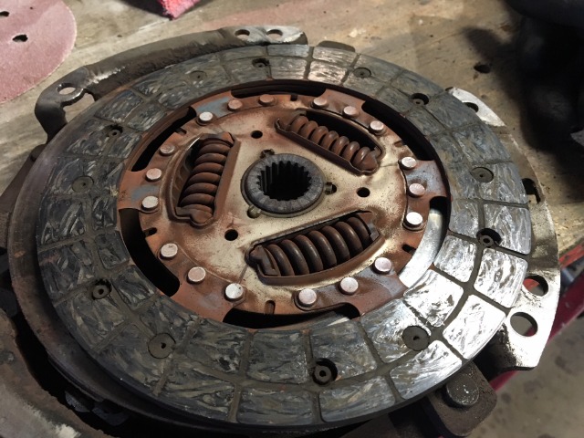

Had a look at the clutch. not as bad as expected, but defo due a new one...

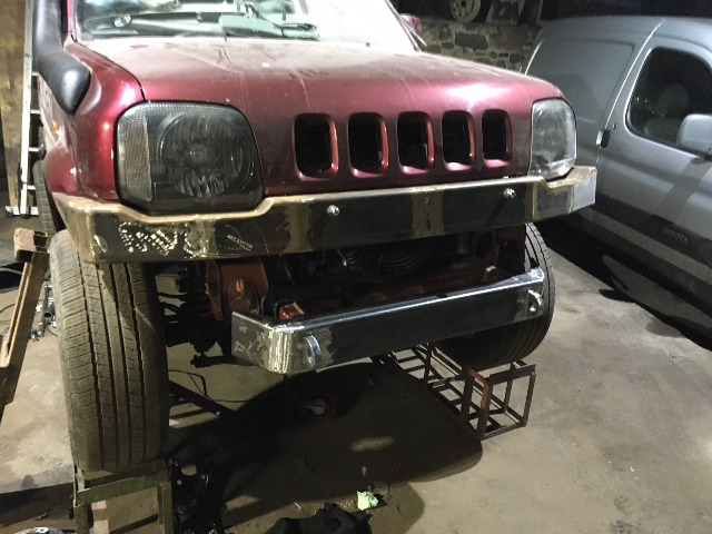

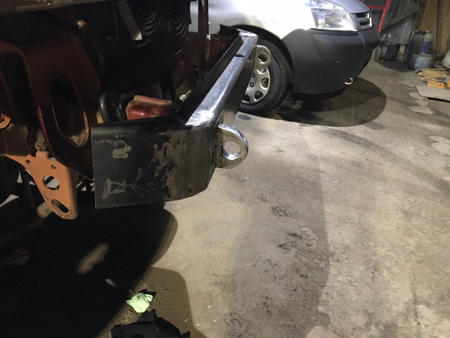

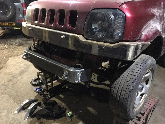

Did also have a go at the bumper again last weekend. chopped the hoop off the bottom and have made a box to go at the end of the chassis rails with curved ends like the top one. Also some box section links and a mega tow point have been made (2x10mm thick steel plate). Another tow point to make to match and these will work as mounting points for the bumper to chassis, as well as brace it all together. Forgot to take and pics of that of course :laugh:

Taken some pics of the front lower bit now its together but not mounted. Gives 2 very sturdy towpoints that bolt through the box section and into the chassis rails a fair way. Looks like its sticking out in one of the pics as ive not got it bolted in place, but fairly happy with it so far.

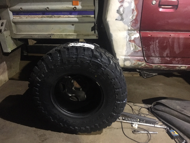

No pics of most of that, but heres one of the new boots that have arrived today...

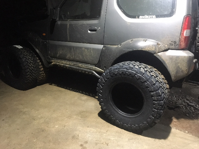

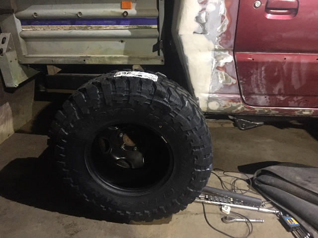

these are 285/75r16 (32.8"x11.2") Toyo open country MT. It will mean trimming the bodywork to get that huge tyre in there, but thats not the end of the world.
Next I need to get the 16" GV rims stripped of tyres and cleaned up/painted to get these monster's mounted. Might see what they are like on J999MNY... :evil:
