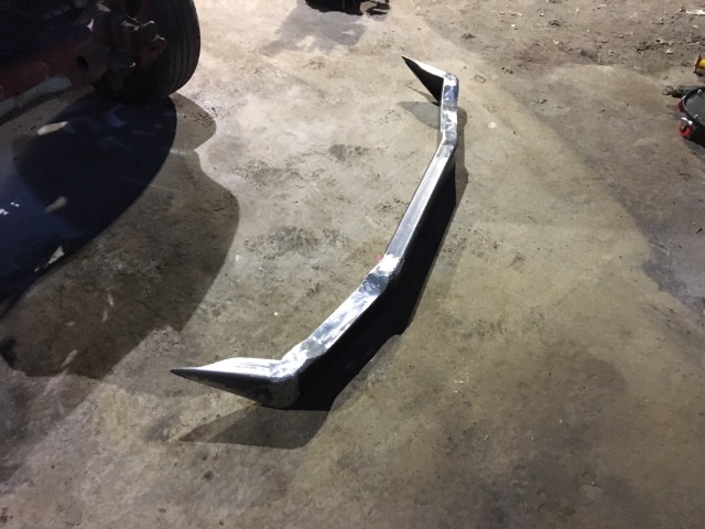

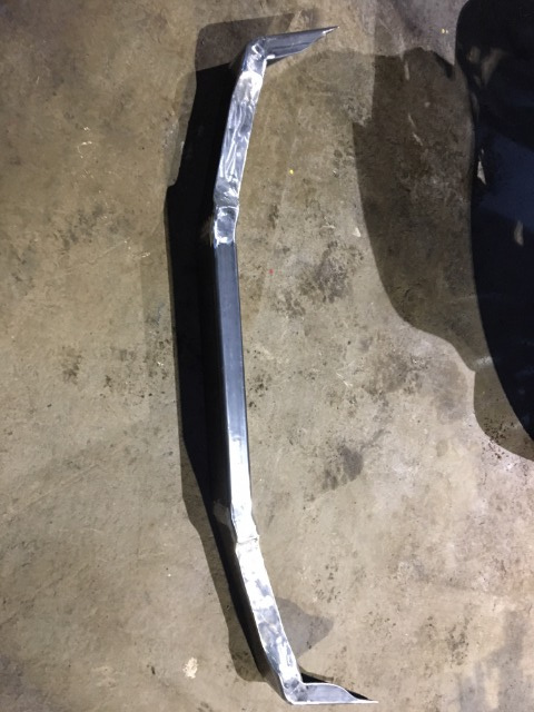

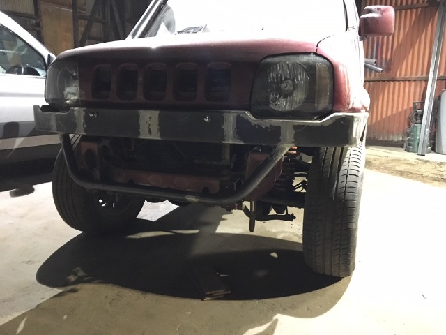

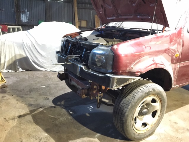

Decided the front bumper looks daft now that the wheel arches are going to be all different, so started making one :silly:
Had a couple of bits of big heavy 5mm wall box section, so after much fiddling about managed to shape it like this:

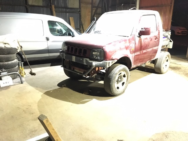

Then a trial fit with a clamp...
Need to put another bend in each side to make the sides tighten up to the wings, but pretty happy with the shape so far. Planning a trapezoidal bit of checker plate to go below it and wrap under the chassis end rails which should finish it below nicely.
Bumper was a distraction because the steel tube i'd bought for the sides/roll bar turned out to have too thin of a wall section to work properly in my pipe bender (made really naff, weak bends). Need to source some scaffold tube as this works well in the bender and is very strong. Whatever the pipe i used for the side bits is also works well (galv gas/airline pipe i think), so maybe some of that would be good instead of huge, heavy scaffold pipe :laugh:
Oh yeah, and as you can just see in the last pic, the new snorkel eventually arrived from china. Its a copy of the one on J999MNY, but without the JIMNY embossed on it (which i prefer). J999MNY might be gettting a new snorkel and Ulysses getting the cast offs again!

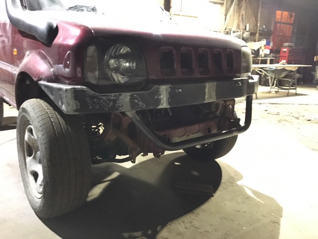

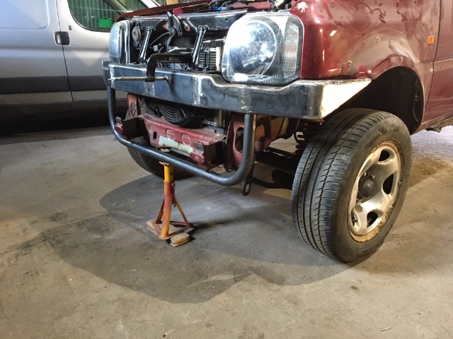

18 Nov 2018 17:33 #197760

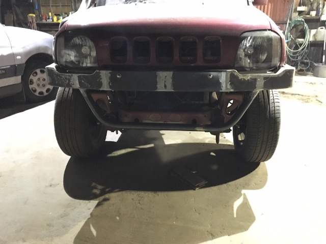

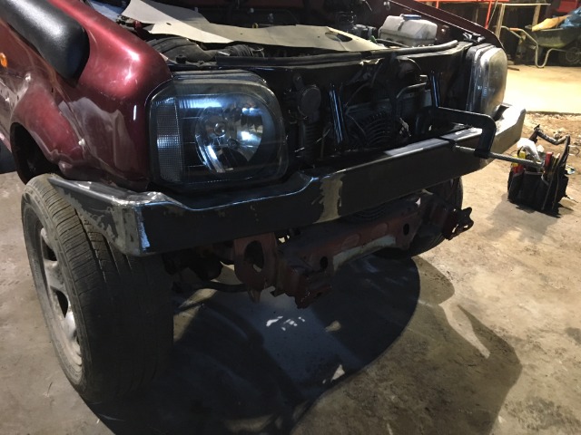

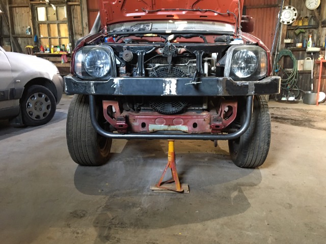

More fiddling with bumper...
Did the extra bends needed and got it stuck on for a test. Bent a bit of tube to see how it looked...
Decided it looked daft so tried with less of an angle and happier with it so welded on...
Sticks out a bit more than I wanted at the bottom, but thats needed to miss the chassis outriggers. After a suggestion of some mesh from Dave rather than the checkerplate Ive bought some of that as well. Radiator in there needs some air :laugh:

20 Nov 2018 06:52 #197831
Replied by X8GGY on topic Ulysses
That's looking great Riccy! Love the recesses in the bumper for the headlights! And the toob looks much better at than angle
