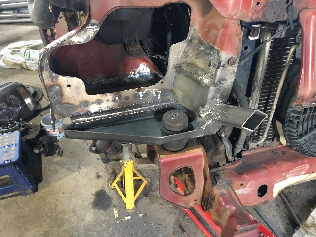

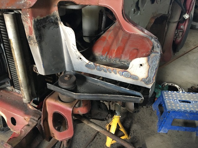

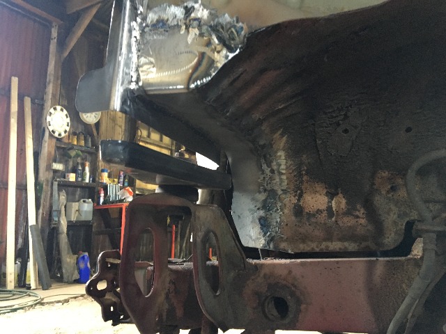

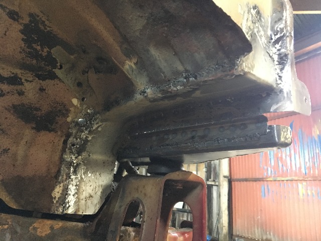

More progress. Front end nearly complete, just the bridge across the radiator to sort. Made some brackets for the body mounts as well
Driverside:
Passenger:
  • MadsV
29 Apr 2018 18:08 #192276 by MadsV
Replied by MadsV on topic Ulysses
Thats some nice bodywork there, good job!

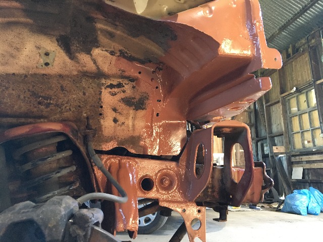

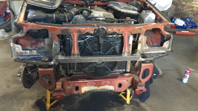

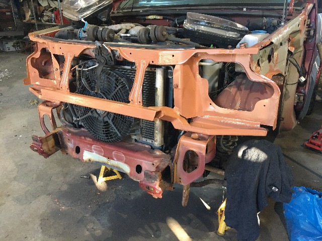

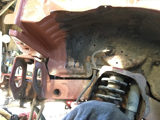

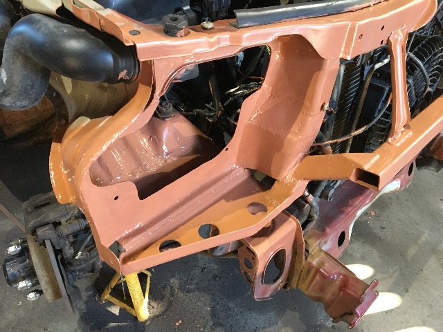

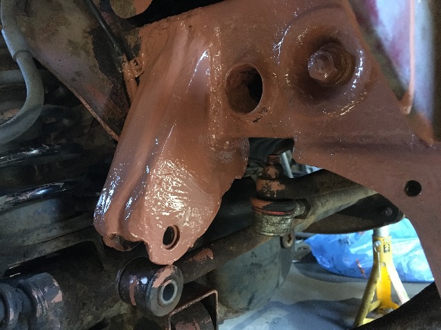

06 May 2018 17:08 #192444 by Riccy
Replied by Riccy on topic Ulysses
Yay! finally, the front end is complete B)
Put the bridge across to join it all together and welded up...
Then a liberal coat of Buzzweld RCP primer (nearly the same colour as the original primer)...
Decided to add some drainage holes into the new chassis mounts as well, they are a valley so bound to fill up at some point.
Also discovered the front panhard mount had a hole, so plated that up and more Buzzweld on it...
Sills and middle body mounts next.
I keep looking at Kiethy's red trayback one and then looking at the angle grinder :evil:. Really tempting, but must at least get this one MOT'd first :evil: :-)

06 May 2018 21:42 #192452 by Keithy
Replied by Keithy on topic Ulysses
It's impressive how much these cars differ/rot differently.....mines a year newer and the chassis is so much cleaner/not as rotten.....still issues to be taken care of though.
Front end looks well mate!
I need a better look at Buzzweld as I want a shiny chassis on the new car.
