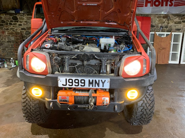

Osram nightbreaker laser bulbs in and working. Cant tell from the pic but the osram is in the passenger side and normal still in drivers...

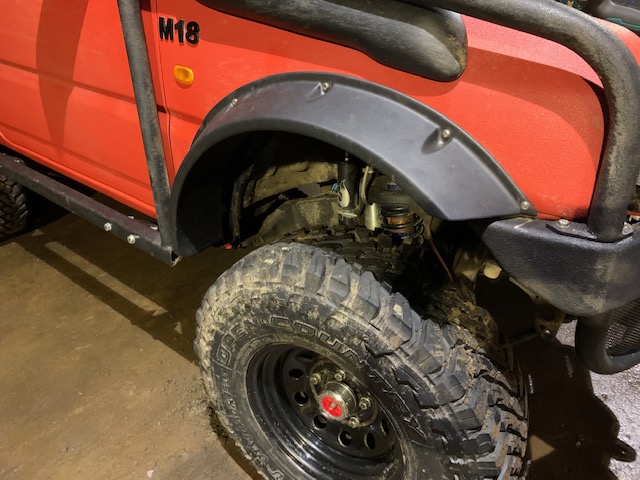

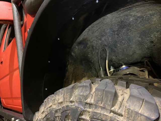

Then onto the new front wheel arches courtesy of Keithy. The ones on it were early model rejects I got from James Priestly, however they didnt fit well at the front end:
So I badgered Keith into making and posting me a pair of the newer ones to fit on:
Which look perfect now

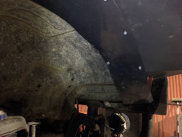

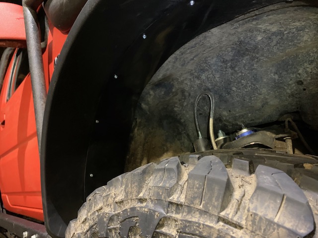

I added some plastic trim to the inside because I was finding a lot of mud getting stuck inside the wheel arch and door hinge area:
So the question 'do i need arch liners' for more standard Jimnys is YES you do. The amount of mud pulled out filled a bucket per side. That lot is extra weight and rust potential a Jimny just doesnt need!

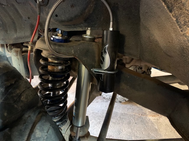

Finally, I couldn't remember if I had mentioned about sorting out a better mount for the Fox shock remote reservoir, but I found that an exhaust clamp was the perfect thing to bolt it to the side of the spring mount:
The Fox shocks are excellent. very happy with the ride and control they give now. Comfy on the bumpy stuff too. The Terrafirma bump stops are working well, but the adjuster collar has started to corrode pretty badly already. A complaint email will be heading their way. I don't expect them to look that shabby after only a month

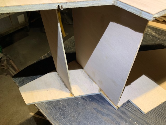

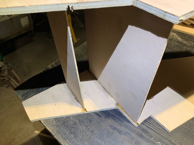

Time off work so plenty to get on with

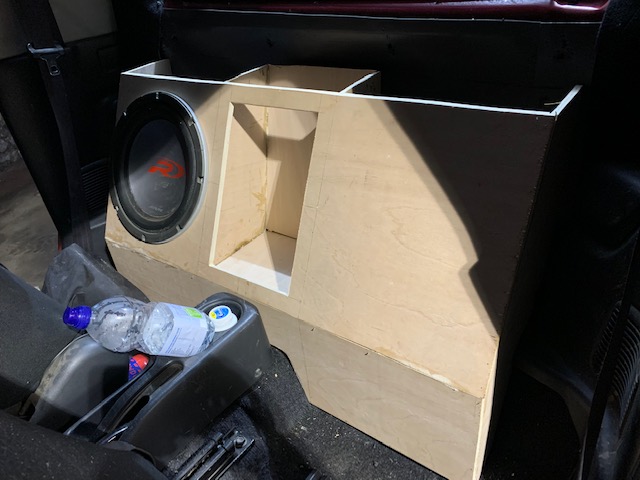

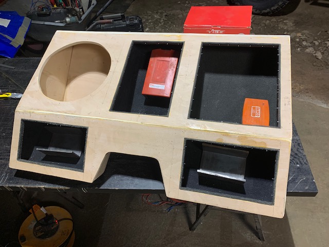

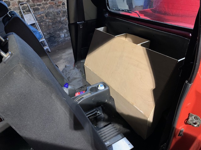

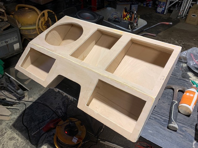

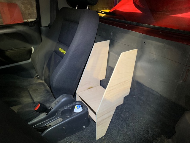

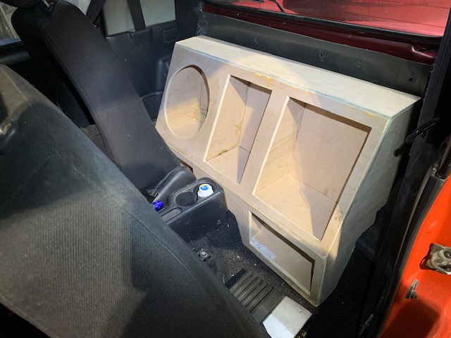

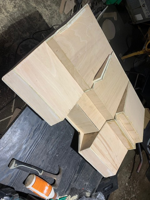

Started making a box for behind the seats for the much loved subwoofer and some storage.
Made up sections of plywood and router'd grooves for it to join together with much test fitting in & out...
Managed to get a start on the carpet as well. Should provide some useful space for odds and ends, as well as the sub. Undecided if the cutout spaces need a door or not and wondering about trying to integrate an arm rest to extend between the front seats for comfort reasons.
More tomorrow probably...

Replied by jackonlyjack on topic Ulysses
Built in sub back massager for them long trips
I like it.......I would have considered a 12v fridge in the centre
