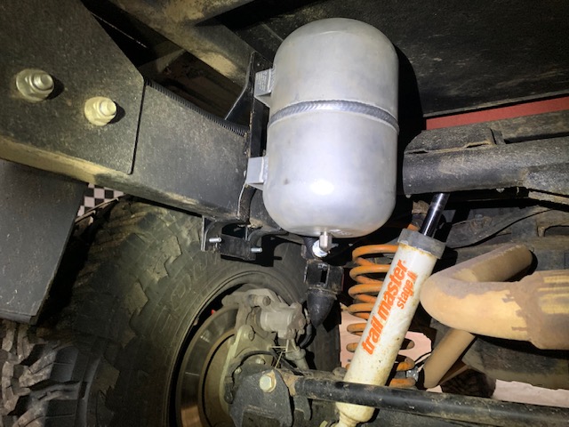

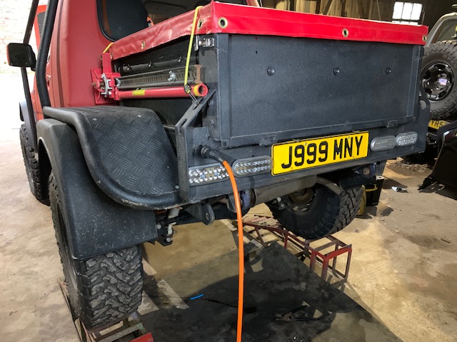

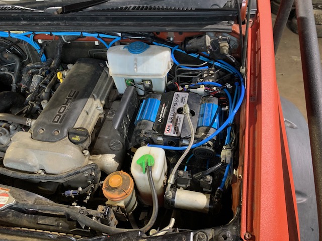

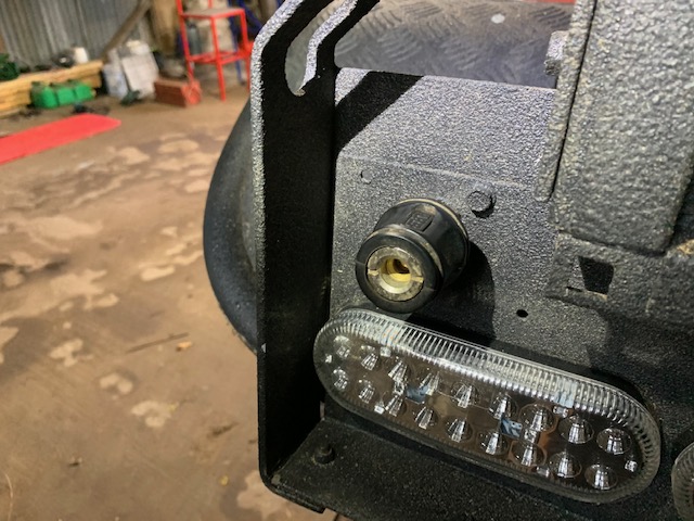

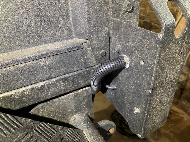

Finally got round to fitting something i bought ages ago for the grey one, but on Ulysses of course.
A small ARB air tank to act as a reservoir for the airline socket. Previously I just had the airline socket straight off the small locker manifold, which worked but was only good for blowing up tyres. Now with the air tank I can run small air tools as well. Another bonus is the airline socket is now on the back bumper so much easier to get at than under the bonnet. I have added a small 12v air solenoid to enable me to isolate the tank/airline socket incase of pipe/tank damage, but also to stop the compressor charging up the tank when im driving and using lockers.

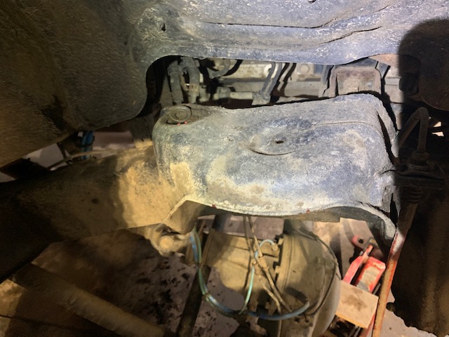

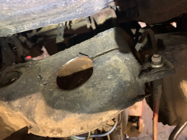

Cut off the old bump stop bracket level at where the rubber spring seat bottom is

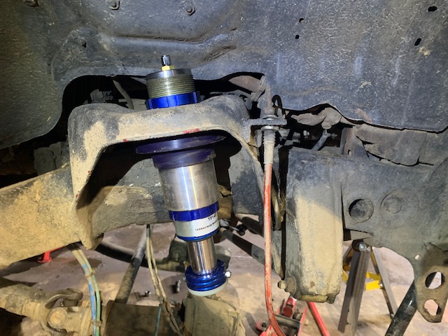

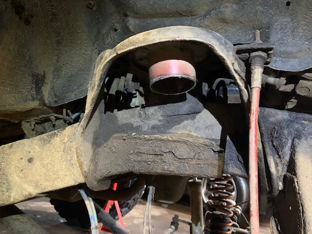

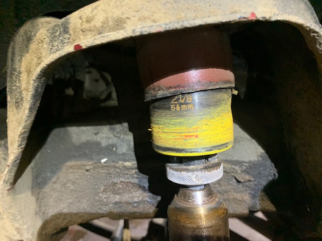

Use a 52mm holesaw to drill up inside and through the spring seat bracket (note - I bought a brand new starret holesaw for this and it was knackered after one hole, so buy two or something better. This is also why its a 54mm in the pic)

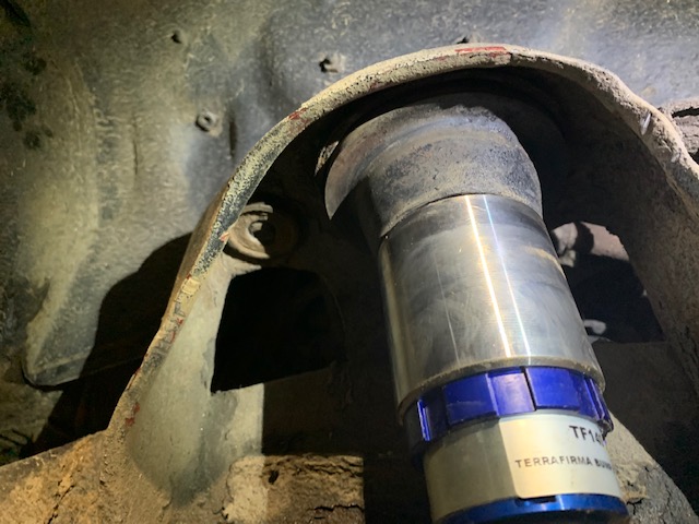

next to put the bump stop in. It comes with 2 locking collars and a large spacer collar. I needed it fairly long to suit the Fox shocks, but had to fit it on its minimum setting to allow the spring to slide over, then lower it once the spring was seated properly. Not too bad to fit.
slid the poly spring seat/spacer thing onto it and its a great fit

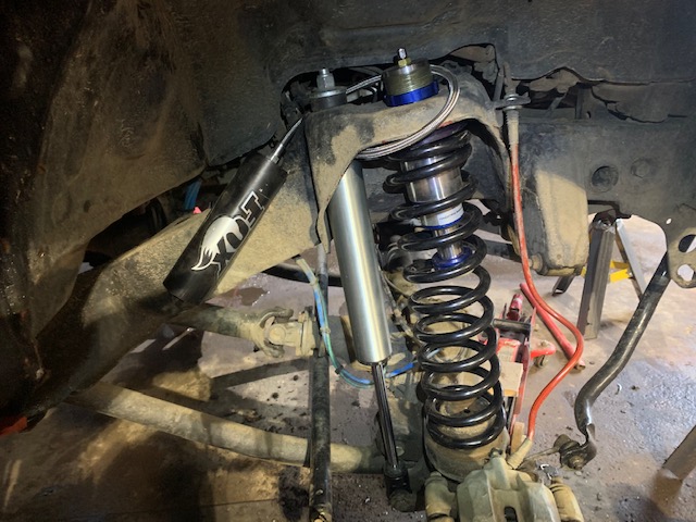

Spring over it now and the shock mounted. Looks pretty cool
Need to sort out some sort of mounting bracket for the shock reservoirs now. For now ive used large tie wraps to strap them to the chassis out the way of tyres.

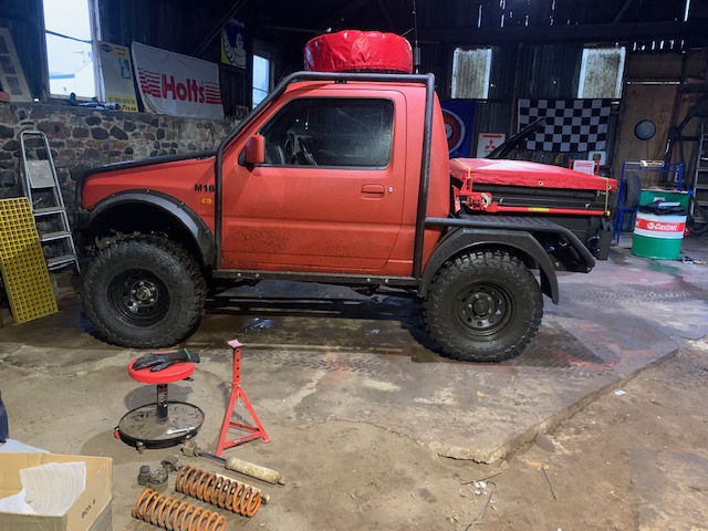

sitting a bit odd...
Nevermind. Test run out down the coast on my usual short test route and its amazing. The shocks are soo much better suited to the weight. Much more controllable as well. Very impressed.

I should say; in that last pic there were 4 20kg bags of floor screed in the pickup bed to represent load conditions
