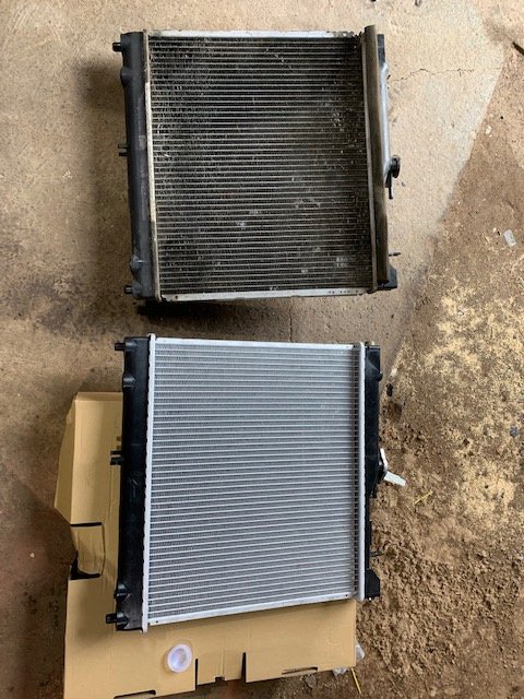

Nice new radiator arrived today. £36 ebay special. fits well...
So after fitting that, filling with oil and coolant, double checking all is plugged in and fitted tight it was time to crank by hand first (to get oil moving about the engine) then onto the first try by key:

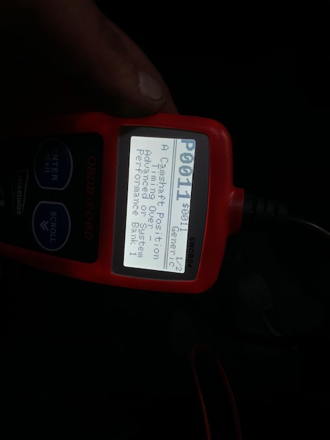

Code reader (should have thought of that first!). Shows code P0011:
Going to try and swap the crank sensor tomorrow. If not that then its probably the trigger wheel, so engine back out time

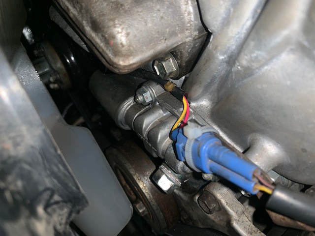

Also have oil leaking from this thingy:
Which is something to do with the VVT apparently. Have spares and its not too bad to get to thankfully (easier than the crank sensor at least!)

The vvt thingy on the front swapped and that cleared the code P0011. Tried swapping the crank and cam sensors, still not working. Went to town and bought a compression tester and timing light, both showed ok. Last thing to try was the fuel therefore. I had fitted the larger injectors and after swapping back to the standard 1.3 ones its all happy days.
