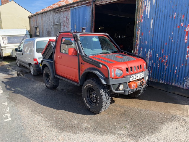

I had booked this friday off as a prep day for going lanin' to Strata Florida in Wales, but that trip got cancelled. Still decided to have a good going over Ulysses to check for the source of annoying rattles.
Top of the list was clunks from the front axle on dips in the road. Source was loose bolts on the radius arms and front shocks. All tightened up well.
Another noise issue identified was that the rear engine mount (on the back of the gearbox) was 1) missing the bolt, 2) bolts onto gearbox loose, 3) bush broken on stick linkage and 4) too low so the prop was hitting the stick linkage.
So tightened up and replaced bolt & bush. Used spare spacer rubber to lift gearbox up on its mount. One of the gearbox to bracket bolts has sheared off
A problem for another day perhaps.
test drive and it works much better now. Quiet and no knocks or rattles.
The only picture I remembered to take was just after washing it however...
