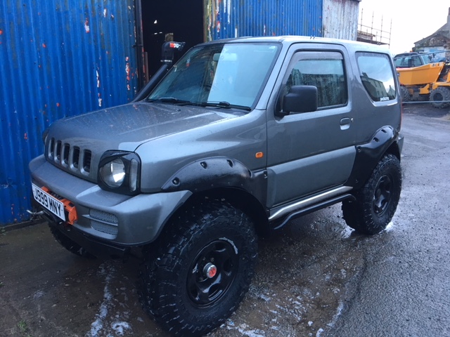

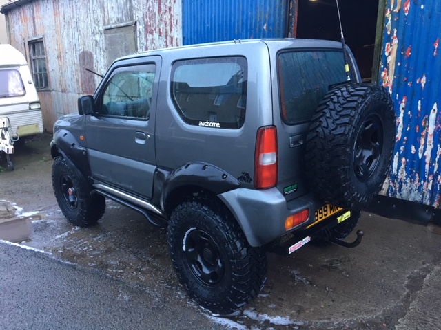

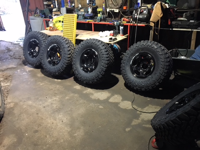

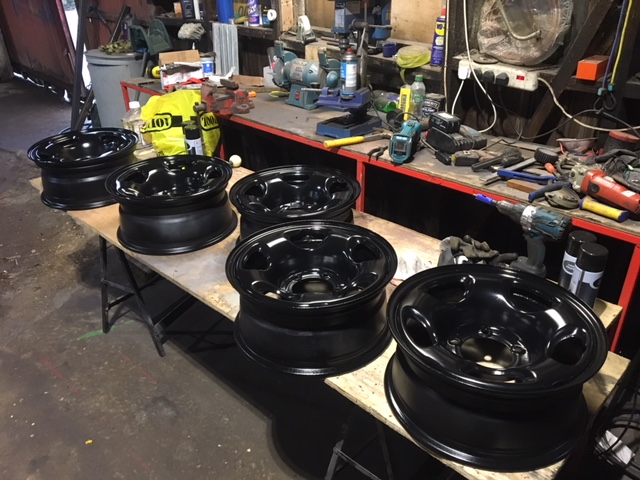

Tyres were fitted and balanced on the nuts as best they could. Methinks balance beads are needed instead, but thats another story. They of course ended up on J999MNY for the crimbo outing :laugh:
Bit of extra trimming of arches needed but they fit and match with the rockwatt transfer gearing properly at last. Speedo is off, but thats to be expected.

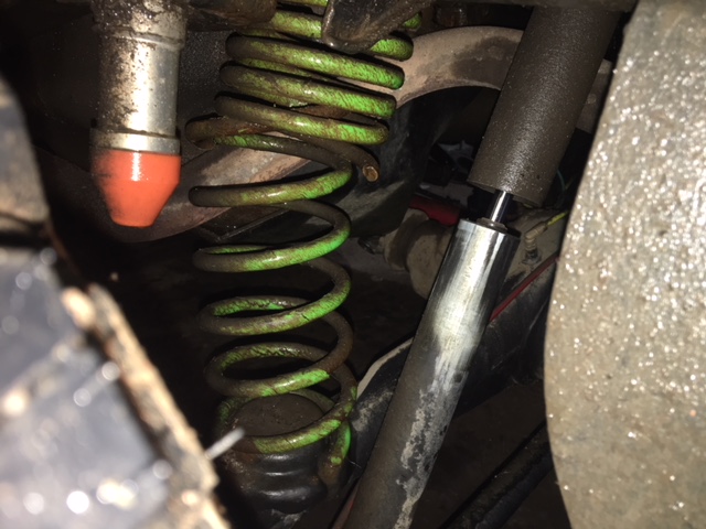

Then this happened:
One of the rear springs snapped in a bad place
:pinch: Cue a rushed trip to pickup some springs and other bits from James Priestly and Kev Duckworth for greenlaning on the 30th.

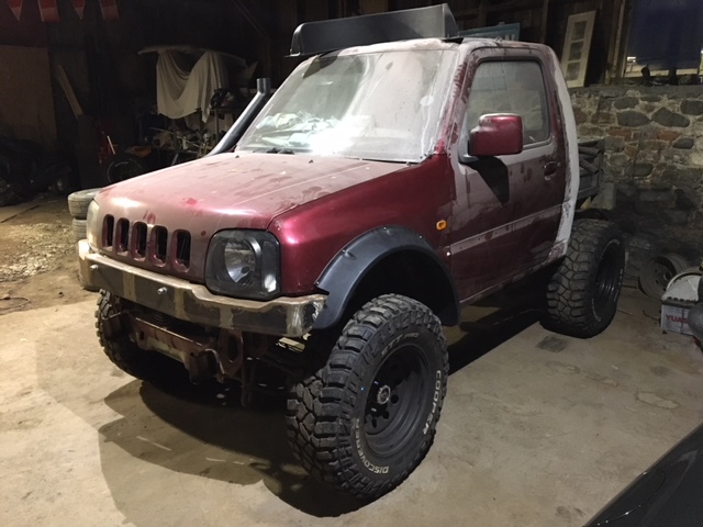

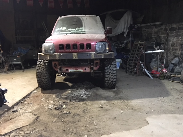

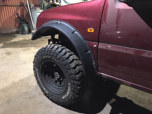

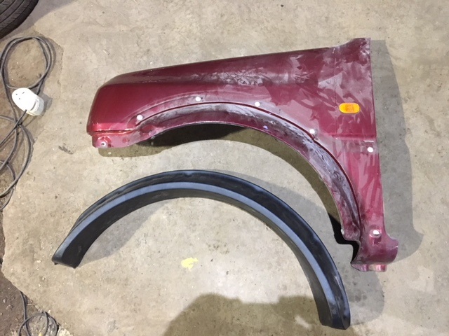

Now that ive got it back in and bolted up with a new clutch, the rocklobster box from TomDK went in (5.14 ratio and a spine'd cradle). On with the Cooper's on 15x8's and 30mm spacers for a test fit. Trim up the (again cast off's) arches which came from James Priestly, but are the ones Kiethy was making, rejects apparently.
Out with the grinder and a bit of trimming to fit around the steel bumper and its looking like a pretty good setup now. Ive asked Kiethy to make a new set of arches next time he's got the machine on as they are a bit different now at the front end and would need less trimming (plus ive made a bit of a mess of trimming these first time around
Does look nice and wide now though
Maybe the 2" lift is enough? those tyres are 31" so thats where most of the clearance will be gained, lifting the suspension further would help the radius arm mounts, but thats about all...

31" without bodylift?

There is a 2" body lift in there I had forgotten about (well most of one!). Its also got 2" trailmaster kit in there so I guess 4" total lift. The tyres would probably work without the body lift kit if I bash out the arches enough. As it is with the total 4" I will need to trim out some of the wheel arch inner bits and bash at the front body mounts a bit, so perhaps worse without the body lift, though not much worse. These arches from Kiethy are great and give loads more clearance around the wing as you chop about 2" off the bottom edge of it to fit them.
