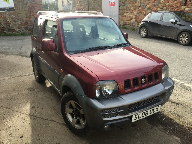

Hi All,

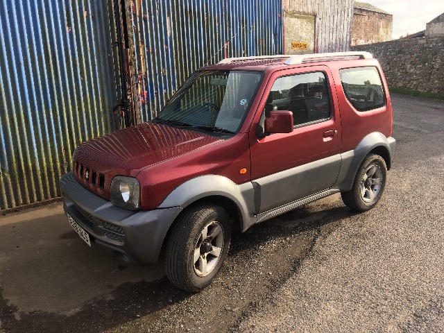

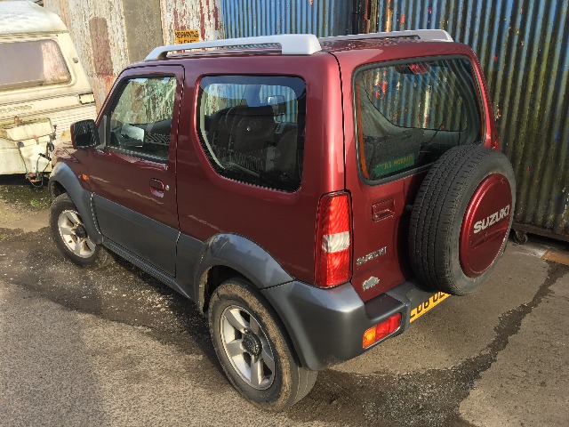

This time ive decided a build thread is in order to keep a history and track of progress. Delivered today (17/4/18). £200 Bought as MOT failure from a garage near Kirby Lonsdale and transported by Steves transport (very good and only £100). Put onto it by forum member TonyL and met him when viewing (really nice guy with an identical red & grey Jimny).
Introducing Ulysses. Name has been decided upon based on the last three letters of the number plate (ULS). First time I felt the need to give a car a name. (Joel was happy to call it Useless).
My current Jimny (J999 MNY) is to continue to be the main beast, with this being the project/research model. Ulysses may also be used by my usual winch bitch (Joel) for when were out -n-about without the rest of the crew (or he might end up joining us in it on our outings, who knows!)

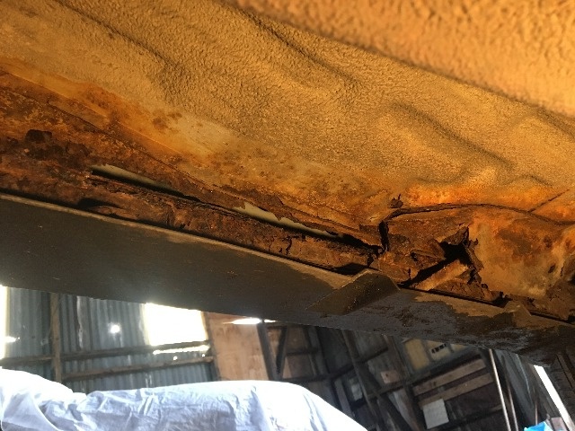

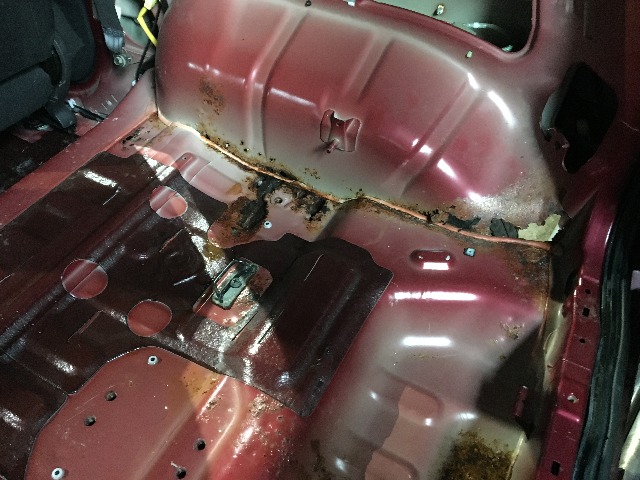

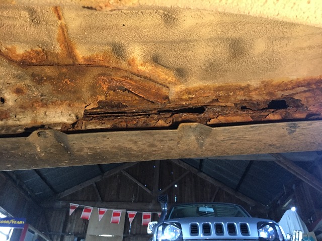

- MOT failure from rust (yet to fully investigate but its defo new sills, front body monunts/behind headlights, bits or arches and probably back floor).

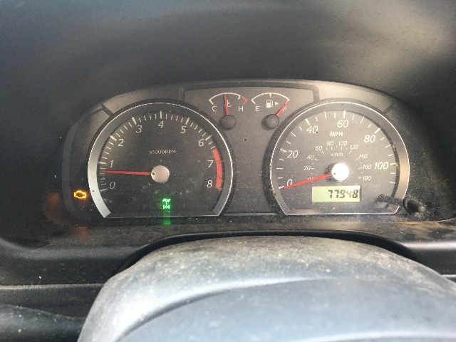

- Engine light on (solved now as was a loose vac hose).

Clean, strip down and have proper look at the rust before buying anything. All plastics off. If its within my abilities to weld back up then on with that (should be pretty easy stuff fingers crossed). Then its in this order:

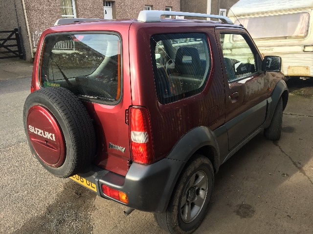

And finally... parked up next to big brother...

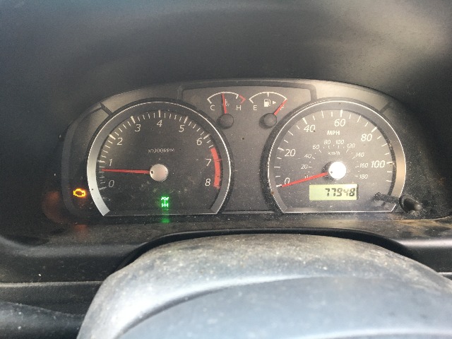

The manual hubs are because all the vac lines are as rusty as the rest of it. They leak, so the 4x4 light flashes and they dont engage. the 4x4 controller goes into fault and thats the end of it trying to engage the transfer box. It can be fooled into engaging the t-box into 4x4, and using manual hubs is a work around for the leaky vac pipes.
when it arrived the engine management light was on, which was a loose vac pipe from the inlet manifold (someone had been trying to get it into 4x4 without knowing what they were doing). stopping the vac leak fixed the engine management light, but nothing for the 4x4.

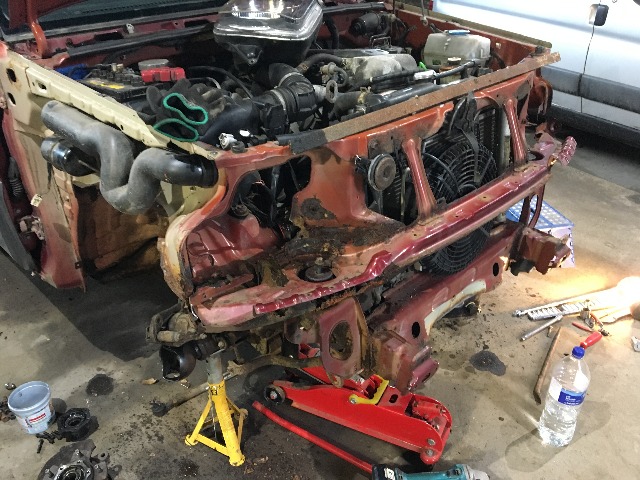

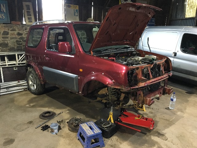

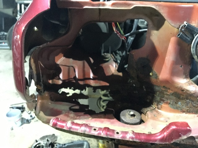

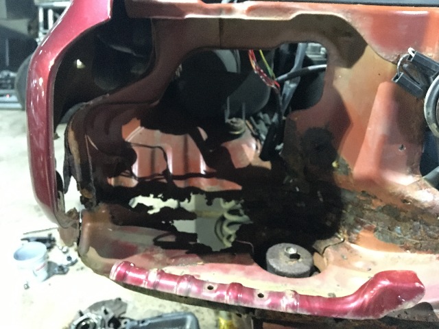

My friend Joel came round this weekend to help with the strip down and asses.
Half a day saw all the bumpers and side plastics off (apart from doors) and a good blast with a super powerful petrol pressure washer.

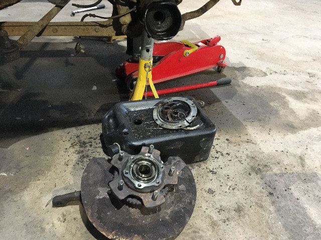

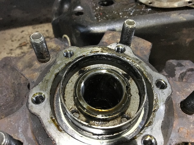

Back in the garage we decided to spend the rest of the day playing with the 4x4 to see what was wrong with that. Front wheels off and on stands. reconected the vac hoses correctly and tried the buttons. flashing 4x4 still. Took airlines off both hubs, one at a time and found a vaccum was working well and that stopped the flashing 4x4 light, t-box engaged ok. So problem in the hub.
Drivers side was making a clunk noise when turning lock to lock, so strip down to find the CV is goosed as well as the kingpins
Also found its had the wheel bearings changed by someone without the correct tool (used a chisel by the look of it).
Need to source a new CV and driveshaft. think the vac hubs may need replaced as well (have spares already from J999 MNY).

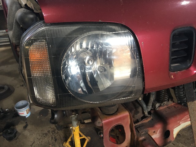

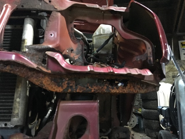

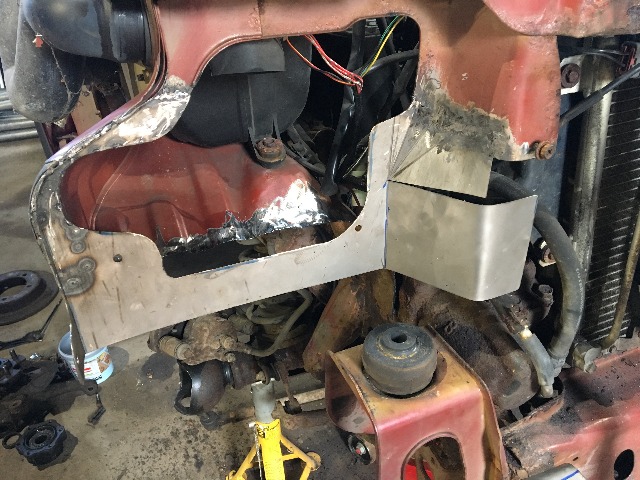

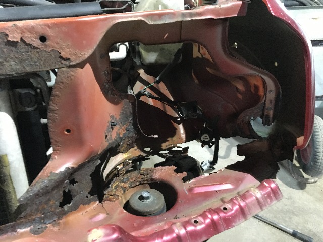

Sunday (today) i was on my own so started cutting and welding jobs on the front end...
Made cardboard templates from J999 MNY and some 1mm sheet steel cut/bent to fit resonably has got the headlight back supported again and in the right place. The whole front bottom panel was gone, so its in the bin now and im going to get creative and make something new
