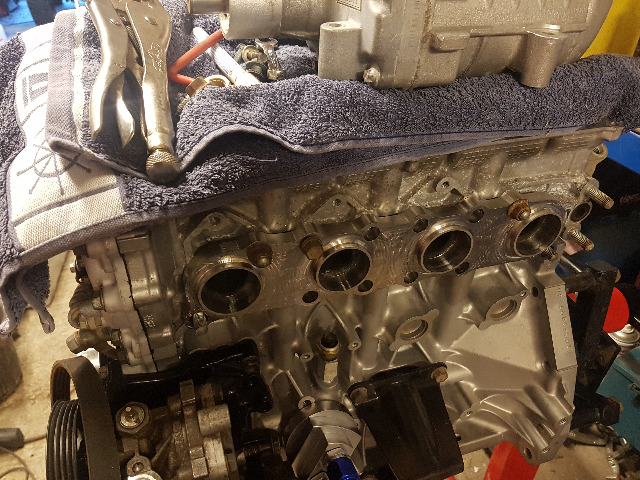

Bigger injectors coming? The blue are for the 1.6 I think?
www.ebay.co.uk/itm/4PCS-450cc-fuel-injec...?hash=item5b56ba3139
Ive got some of these in the stash (but proper denso ones) ;-)
Did the swift AC take much fitting? and I see you have the swift/liana crank pulley there, does that relate to the AC compressor?

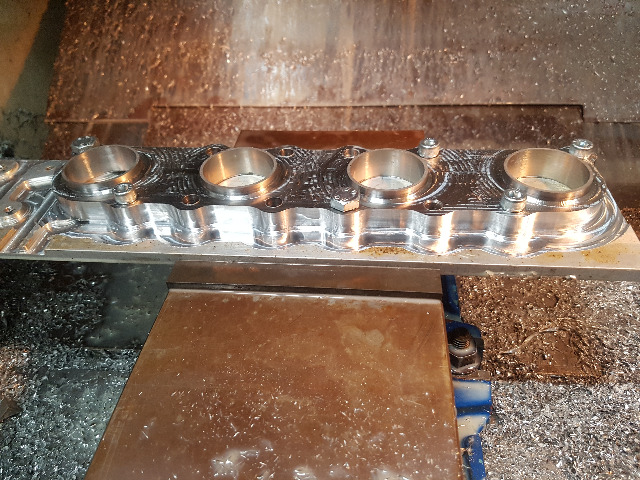

Fridays job never happened so I took the opportunity to make the exhaust manifold flange.
Just need a turbo flange now.

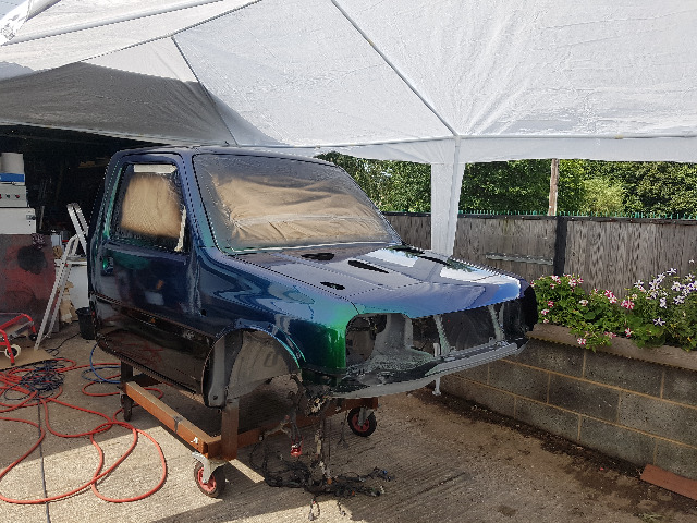

Finally after a full year I have it painted how I want it.....weather was against me last year after taking on the task of finishing a friends trayback.
Axles and chassis to start next.....once the interior is back together.

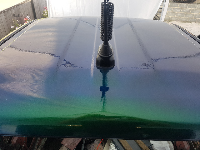

Made a cover for the roof aerials to keep it looking as if someone cares.
