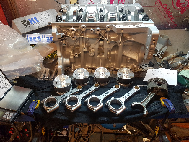

It's a billet piston which is quite oval and with a teflon coating....standard type ring compressors scratch the skirt......so the better way is to use a tapered guide for installing.Riccy wrote: Please excuse my ignorance, but what is that and what is it for? :laugh:
Not being that familiar with tuned engine builds and all
Mine is 78.5mm and nobody makes one.
Jack gets ebeer and brownie points!

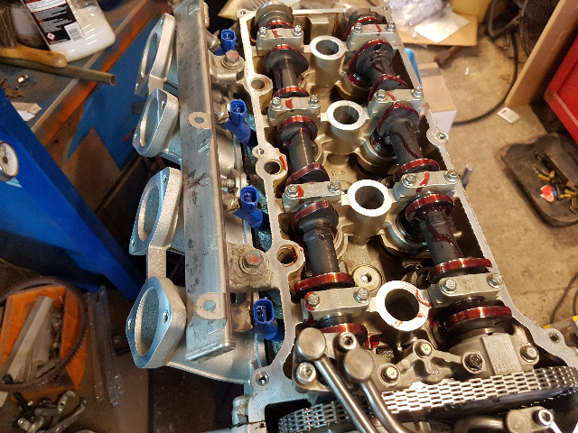

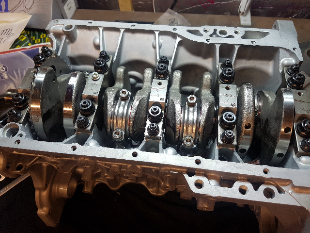

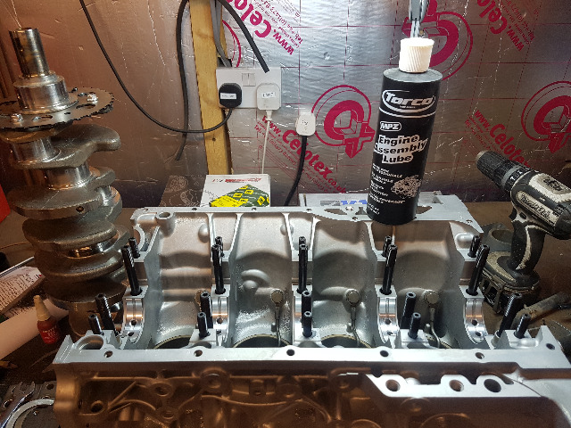

Finally started to put the engine together.

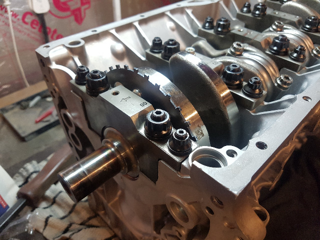

Checked the fit on the trigger wheel...all ok so far.

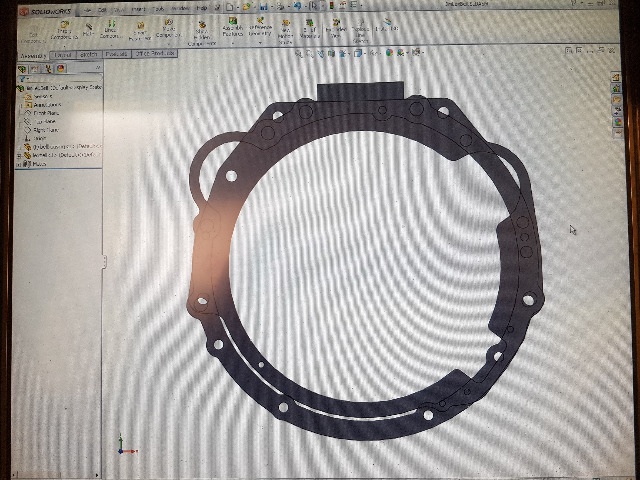

Drew both the bell-housings up ie Jimny and the Lexus....overlapped them in software....only 2 bolts are in conflict....happy with that.
A spot of drill tap and weld-drill should sort that.

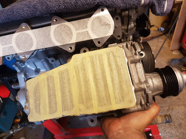

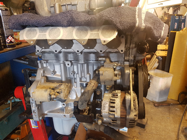

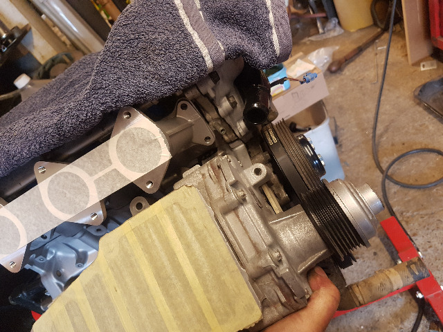

Couple of things to think about....oil pump etc......then on to mount the Supercharger and the Turbo.

I had never seen inside an "M" series Suzuki before........
All those counter balances.. four bolt caps.... and then forged rods and pistons..... I hope your cams are good for 8,000 rpm, your bottom end is....
Cracking stuff Keith....
