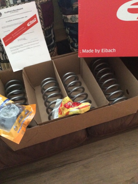

Just waiting on some castor correction bushes but springs, panhard bushes and 25mm seat are ready to be fitted next Wednesday.
The quality of the Eibach springs appears to be very high, I wish my car had such a sparkle in the paint, they are in equal length pairs so the thicker seat will be fitted on the drivers front.
sniper

If they're equal length pairs just because they are taller doesn't mean that you're going to need a thicker spacer th level them. As in I think you're going to find 25mm is too much and will make it lean the other way.

The springs are all part numbered, rears are the same part number on each of the pair, same for the fronts. There won't be any bias across an axle, so chances are it will lean.
Yes, 25mm might be a touch severe, I see where your coming from...... but... I'm fitting the existing 15mm seats with the new springs and it will only give +10mm to the osf. I'm only 10st wet through, I think that will be enough to level it.
sniper

So a total lift of like 65mm?

Hang on I'm confused. You're wanting to have a 15mm spacer under 3 springs and a 25 under the other?
