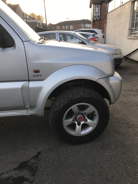

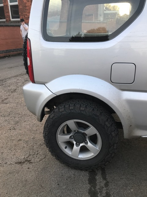

Well, that's a tad more lift than I was expecting.......
Dave at the garage did me proud, new springs, poly bush panhard bushes and poly bush castor correction bushes, all fitted for £200
Only had a short drive on a tight and twisty back road and it feels different, a tad twitchy on the steering but I think that's because the lift has tightened the anti roll bar. I might be able to adjust the dampers to address it or it's another spend on adjustable drop links.
sniper

7 years 9 months ago #203136
Lol! :laugh: welcome to the lifted club :laugh:
You should try it for 'twitchy' with huge tyres on :ohmy:
Be interesting to see how you get on with the adjustable droplinks. Mine is better with the antiroll bar disconnected once you get used to the body roll :laugh:
Replied by Riccy on topic Discreet but capable
sniper wrote: Well, that's a tad more lift than I was expecting.......
sniper

7 years 9 months ago #203141
Replied by jackonlyjack on topic Discreet but capable
It looks ok matey give it time to settle
as for drop links drop the bar from front cross member on a spacer (cheap option for now)
