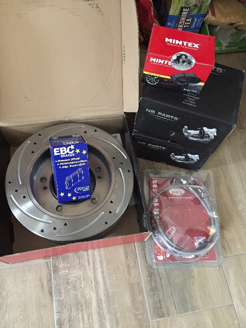

These were fitted and have resolved the braking issues, it was long overdue.
Improved braking and so far....... no fade. The greenstuff pads took a while to bed and they can be a little lazy when cold.
Whilst the upgraded parts have improved braking efficiency, the biggest improvement has been the new callipers sliding correctly and just doing their normal job properly.

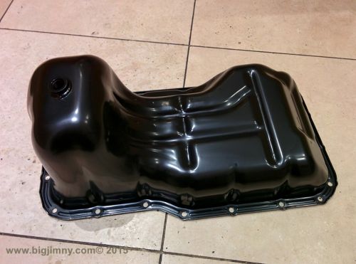

This is my new nemesis, got up to see oil running under the car. My local garage got it up in the air for me and the sump is porous, I was surprised has fast it was issuing. A new one was ordered from Bigjimny.
Getting the garage to fit it when the parts turn up, 3000 miles on the last Mobil 1 oil change....... New Suzuki filter and another 5lt on the way. The oil was cheap from eurocarparts, only £37.

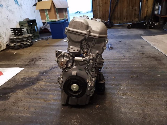

Coming across a brand new M18A Liana engine needs a mention on the build thread.... but for the wrong reasons.
This beauty came to me from a guy in Darlington, brand new never fitted to a car. I was so excited about having such a beast in my car........ 123bhp and 170nm, it would be great.
I was going to run it with a standalone ecu and ITB's, 160hp and over 200nm. In the region of £2000 for all the bits and another £500 for mapping.
The Finance Fuhrer (wife) has put the boot in and stopped all non essential spending on the Jimny. Can't say I wasn't expecting it but it meant that I didn't have a chance of fitting it in the foreseeable future.
I sold the engine on to another forum member and have been promised a blast when it's done. That will have to be enough........
