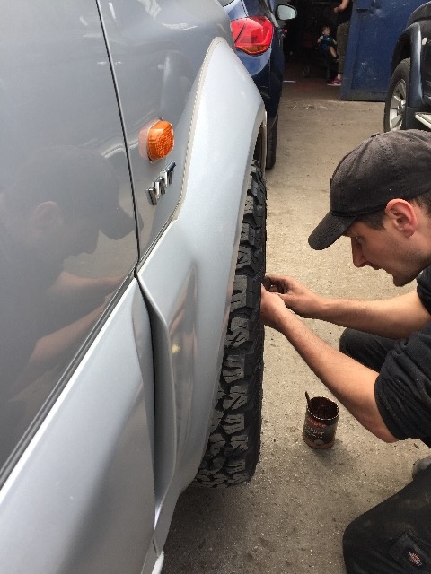

Fitted 30mm wheel spacers.....
A big change in the feel of the car, some catching at parking speeds/angles so will need to remove inner arches (at least) before going off road. Pleased with the look
When I bought the car, it was quite an adventure to drive, you had to keep your wits about you and pay attention to what you were doing, it felt small and skittish on the road. That has gradually changed, each new part has impacted individually and now as a whole it's a different car.
There are a few tight and twisty B roads nearby and the car loves them now, the vvt has come to life with a good service and some Mobil 1. It's quick enough to stay with the average hot hatch if you keep it singing and handles very well for what it is.
The handling and composure are now as good as anything with solid axles that I've driven, so much so that brakes are moving up the list to sort out, I'm pondering diesel vented setup.
Still saving for the ATB diff which will hopefully be sorted in the next month or two.
