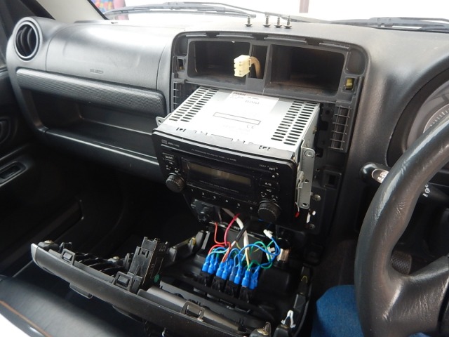

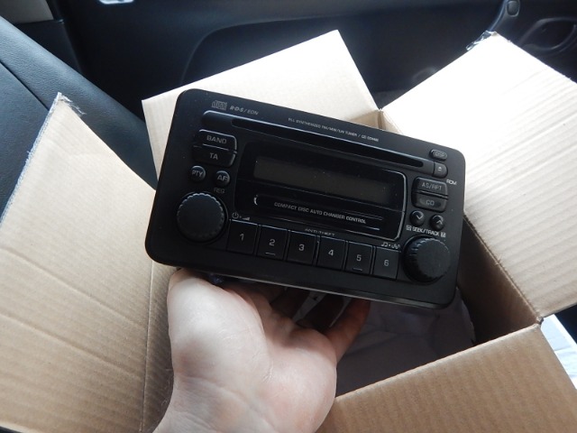

So out came the centre section of the dashboard, and the old stereo...

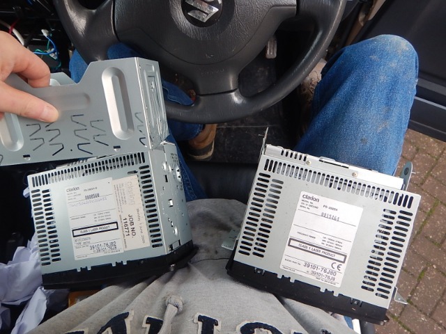

AH, not a nice new shiny Sony headunit then?! :lol: No, the forum member who sent me a replacement stereo had re-used the box from his shiny new headunit... and I'd bought his old one off him as my CD was playing up now and again...
Hmmm, the mounting chassis are different? Swap old to 'new' then...
Balls!
Wrong holes?! Take it all apart again then
LOL :lol:

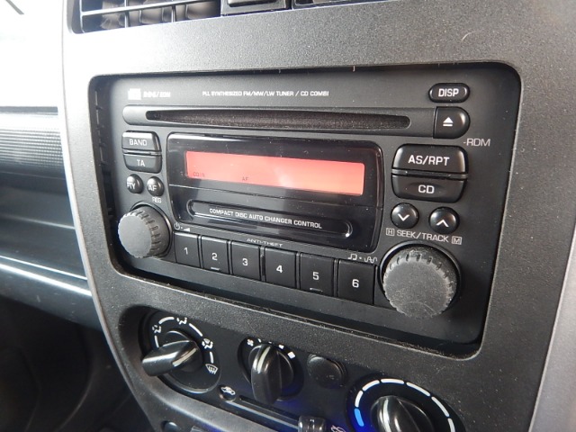

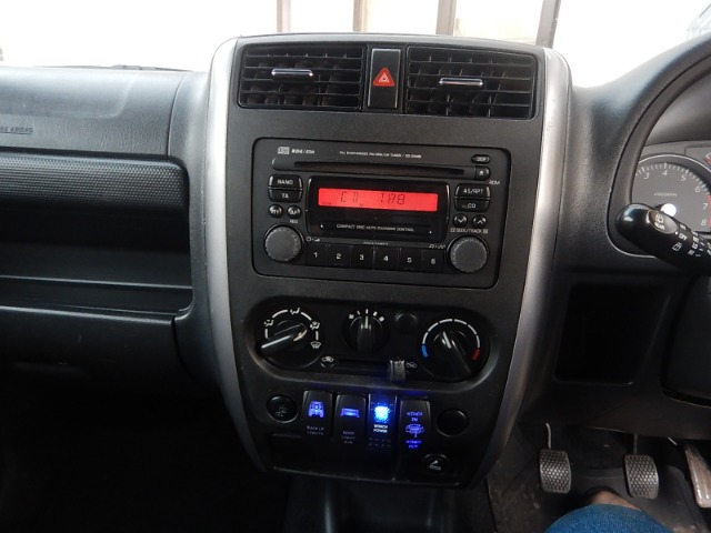

All done, and tested with a few CDs that wouldn't work before...
Had to laugh though, when I first went to test it the stereo wouldn't suck the CD in?
No, surely not...?
Yup, the previous owner had left a "mix-tape" CD in there, I'll offer to post it back to him

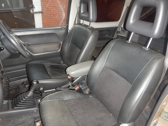

The other box...

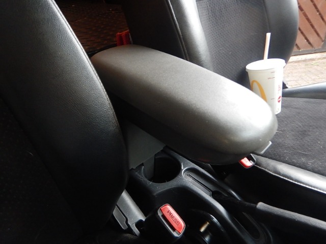

Had an arm-rest in it, only I didn't think ahead, and it's grey and my interior is black (leather)
Doesn't look too bad though? I could always spray it with black Plasticote?
The other problem is it sits in the back cup-holder AND covers up the front cup-holder?!
Hmmm....

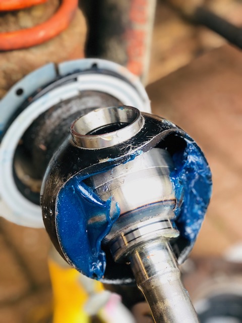

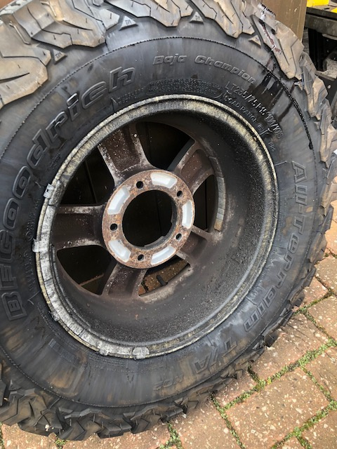

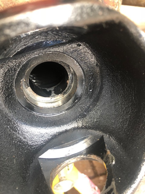

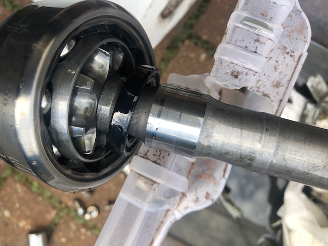

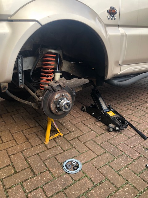

I noticed recently that the offside front hub was weeping a bit of oil, so as I was ordering all new parts for the buggy's front axle rebuild. I bought another set of kingpin bearings, oil seal and ball seal for the Gold Jimny Daily Driver -
You can see thre's a mixture of oil and road dirt on the inside of the wheel

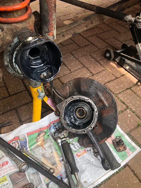

Stripping time then!

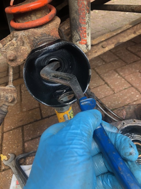

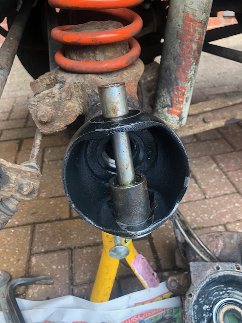

THe bearing shells got knocked out with a perfectly sized socket I have just for this job
I have a special tool for removing the oil seal too...
Errr? But where is it?! :dry:
Ahh... on the shaft still?! Hmmm,that must have been proper loose then?! :lol:
With the new seal pressed in, this photo is just to demonstrate my oil seal removal tool

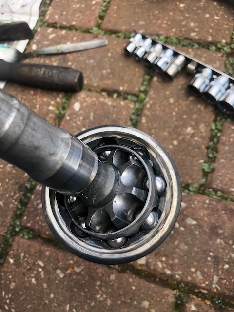

Hmmm, shouldn't there be grease in here? Good job the daily driver doesn't see any four wheel drive action?!

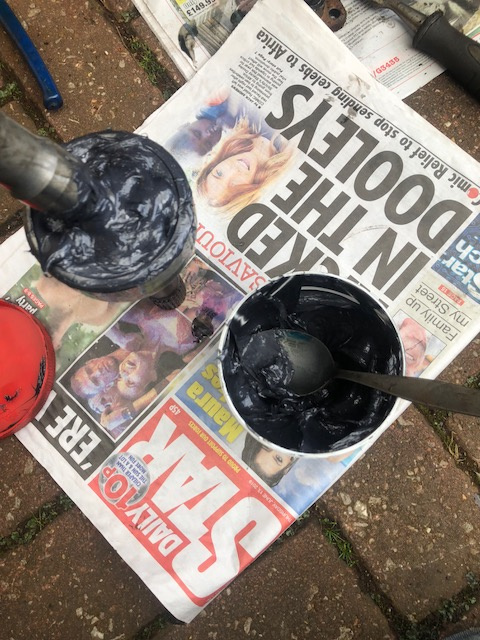

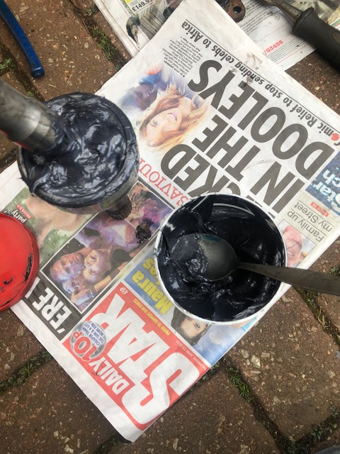

Special Tool #3... Ahhh, yes it may look like a kitchen spoon... don't tell the wife! It's actually a grease applicator!

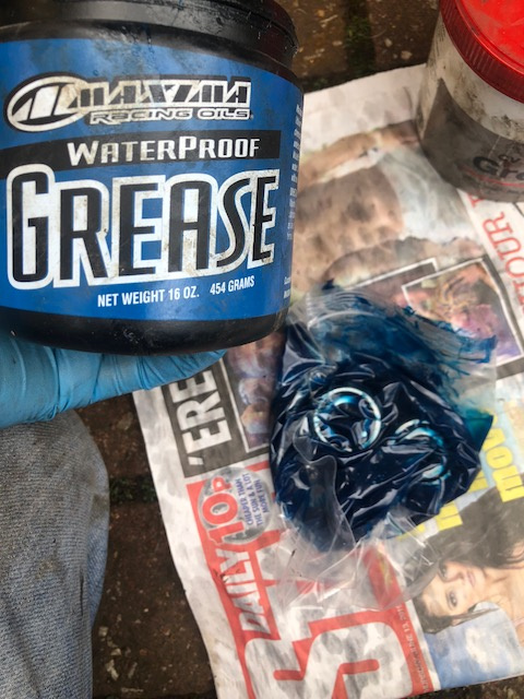

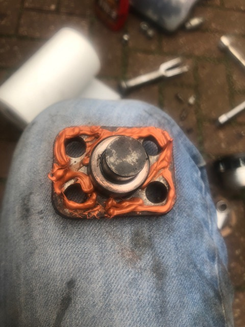

Next, a hint / trick from our own Martin Lines... a plastic bag full of waterproof grease to manipulate into the bearings
King Pins buttered with copper silicone sealent...
And the grease applicator used again to 'spoon' some waterproof grease into the ball, and we're ready for re-assembly...
And then the heavens opened, and it pis..iseted it down
So I carried on but stopped taking photos, didn't want my iPhone getting wet!
All done anyways, everything re-assembled, the inside of the wheel was cleaned with gunk degreaser and newspaper rags, and I also noticed the axle end of the panhard rod's bolt had worked a bit loose, so I nipped that up tight too...
