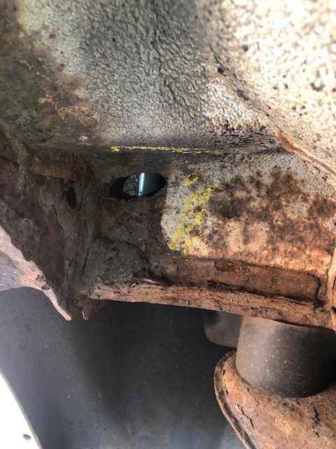

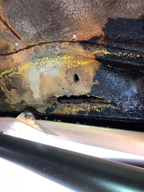

Day off today, so a few little errands out of the way and then disappeared under the Jimny -
Ahh, yes, there's the hole in the offside sill..

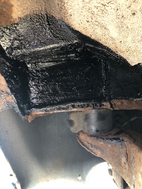

And the back of the rear arch

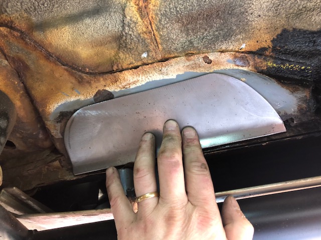

Shaped a patch for the sill...

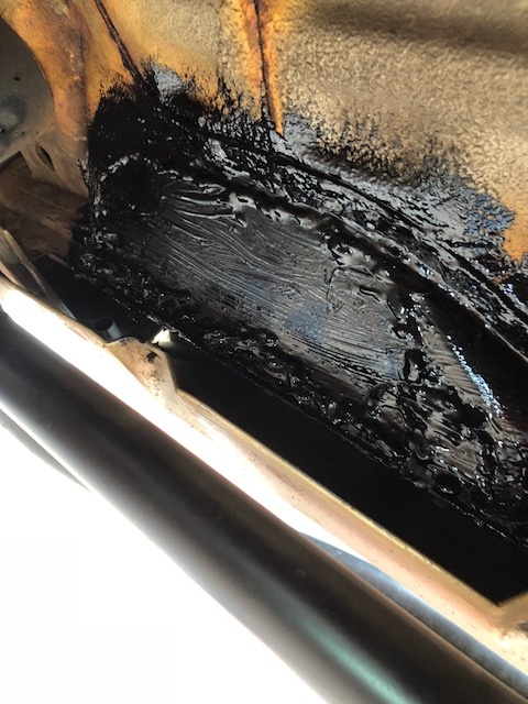

And welded in place and undersealed... tick! One job off the list
And then the same for the rear arch...

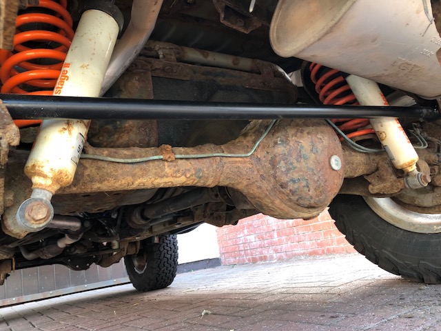

And just had time, or so I thought...
... to only install one of a pair of standard length HD panhard rods from '4x4Outlet' (JimnyBits) on eBay... I was hoping to fit the pair, but like the sills and arches the nuts and bolts are rusty too! So by the time I fought the one off the axle, and cut the one off the chassis, I had to call it a day having only installed the one...
Almost ready for a gentle greenlaning wander me thinks?! :woohoo: Whilst the blue one is being repaired
