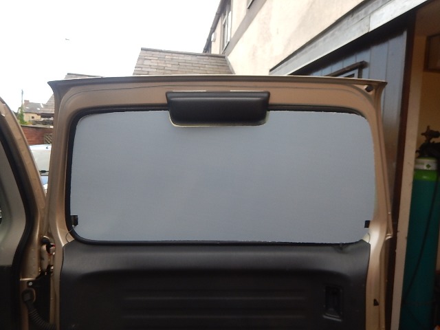

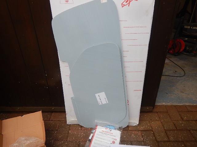

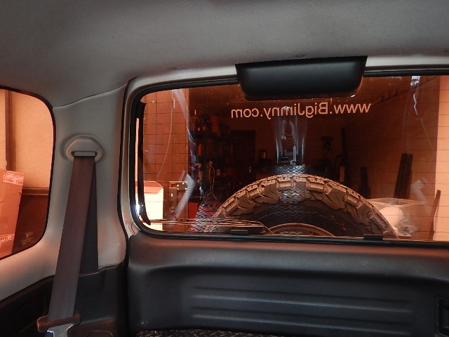

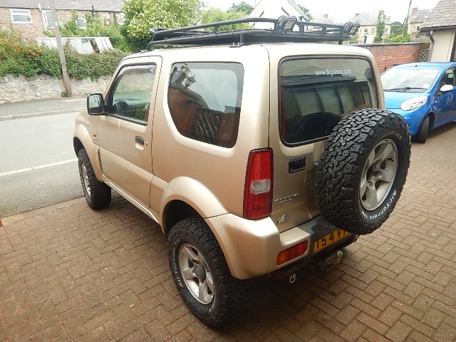

Solarplexius panels. a bit like fitting window tinting film, only a lot easier?...
Test fitting the rear window panel, before removing the protective film off it... I thought I'd start with the rear door as it would be the easiest? No, the side windows are much easier!

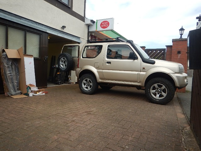

Finished result
A little bit fiddly, but a good result in the end, and a lot easier than trying to fit window film yourself, and a lot cheaper than getting a 'professional' to tint your windows for you
The view out once fitted... a bit like limo' tints, you can't see in (much) but you can see out, through a slightly brown tinge..
Happy with them!

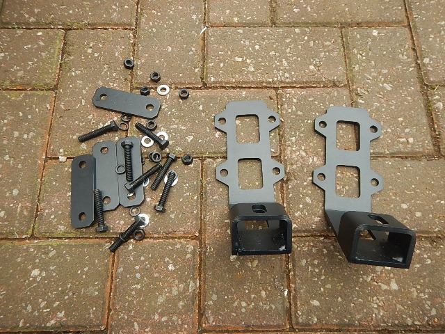

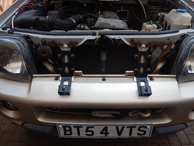

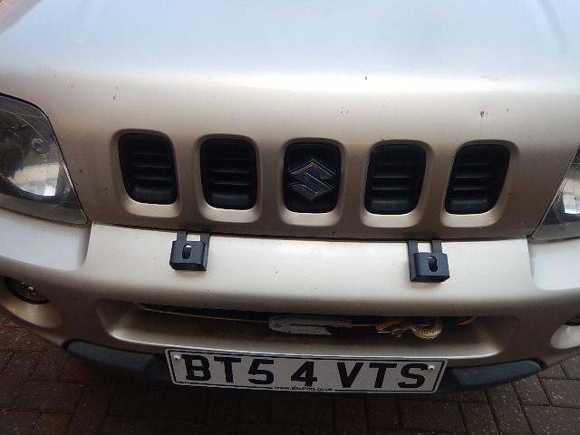

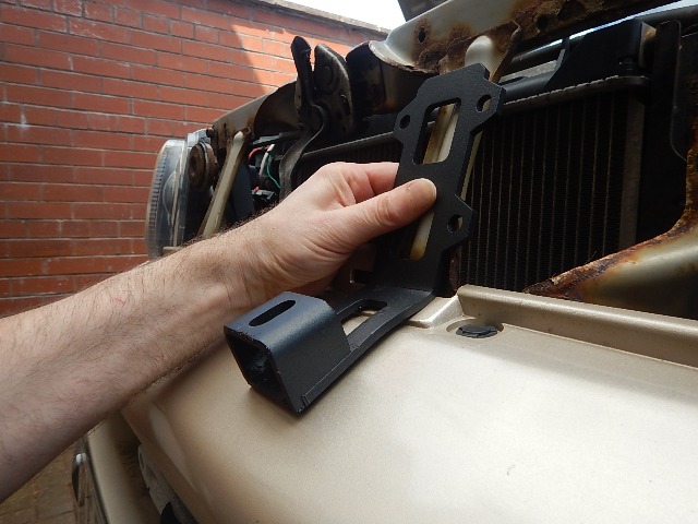

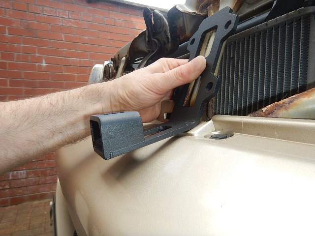

Spotlight brackets from LRChallenge4x4 on eBay...
Hmmm, not the right angle for my '55' Jimny?... I guess models vary over the years?

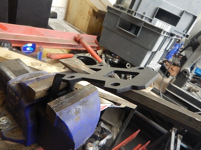

Vice and a crowbar then?...
That's better!
Bolted in place...

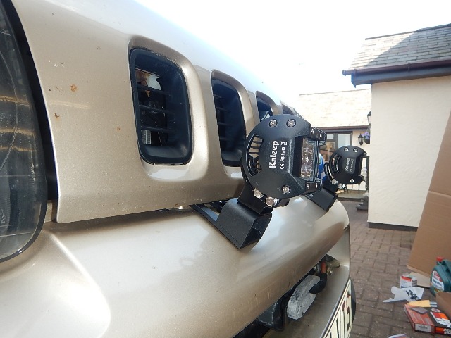

Test the bonnet closes?

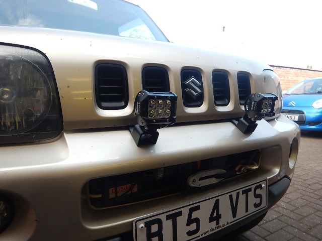

And add some matching (the back of the roofrack) LED spotlights
Yup, happy with them...
That's better!
Bolted in place...

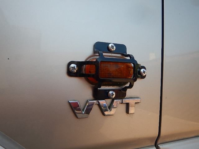

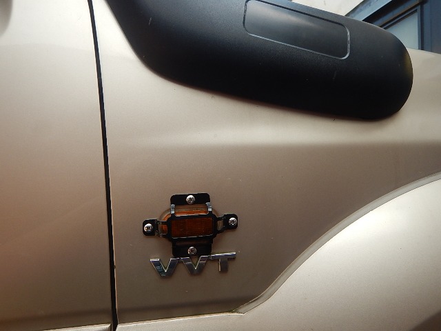

Next some repeater guards from JB - nearside
Offside - under the snorkel

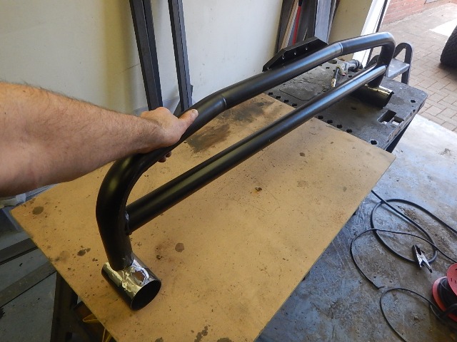

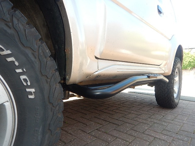

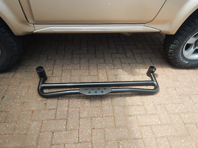

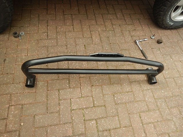

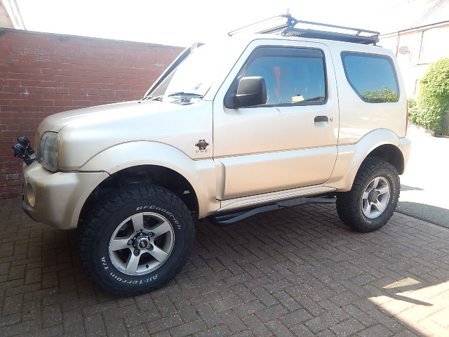

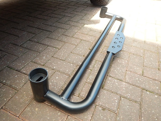

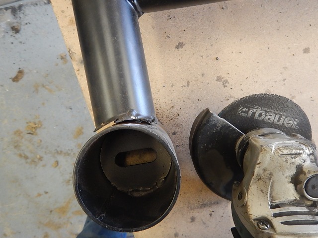

I wanted some nice black tubular sidebars... I prefered the ones on eBay from 'Samurai Serwis', Michal from Poland who I bought the lovely roofrack from, but when I contacted him he said he couldn't make me a special pair for a Jimny with a 2" bodylift. I considered buying his anyway, but noticed LRChallenge4x4 in the UK had a very similar pair but with a different design to the step on them, and they worked out a bit cheaper due to the free shipping, and they'd also get to me a lot quicker...
BUT, the 'problem' is / was all the sidebars I could find wouldn't fit a Jimny with a bodylift, so I knew I'd have to do some modifying...

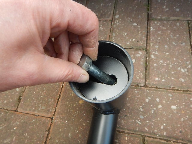

First I checked a bodylift sleeve bolt would go through the slotted hole in the mountings (they're designed to have the bodytub mounting studs go through them and a nut go underneath...

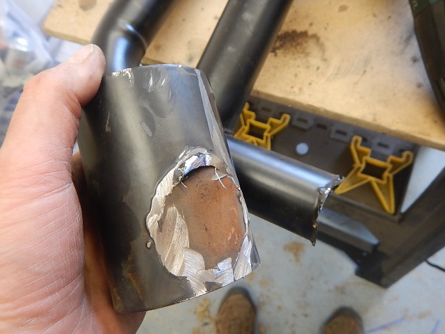

"Mr. Angry" the angle grinder out...
And chop the bars off the mounts!
And then reattach them but up 2"...
Lick of hammerite...
And then REALLY struggle to get them on!
Trying to hold the bar up and get a sleeve bolt up the tubular mount through the slotted hole and the body rubber and over the bodytub mounting stud?! Plenty of swearing required
Done though!...
And look okay!
Ahh, then time to do the same to the other side then?
:lol:

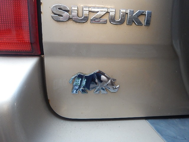

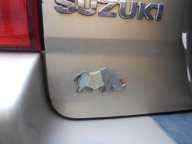

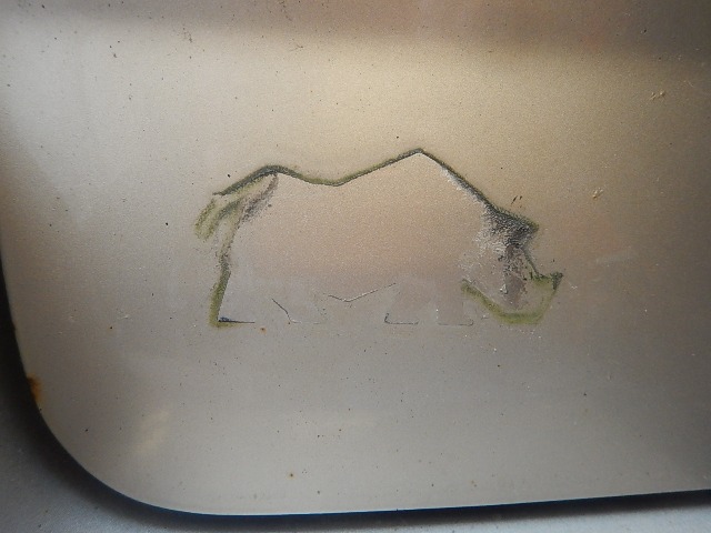

A bit simpler! :lol: Faded Rhino badge...
Scraped off leaving a ghostly shadow!
And a new (ebay) one added
Ummm...

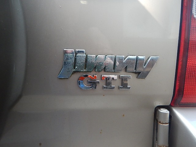

Whilst on eBay I also got some "GTI" lettering... a reference to the Jimny's pokeyness with the VVT engine and gearbox combined with the earlier transfer box and diffs which adjust the gearing for the 235/75/15 tyres but still let the Jimny perform like a "hot hatch"

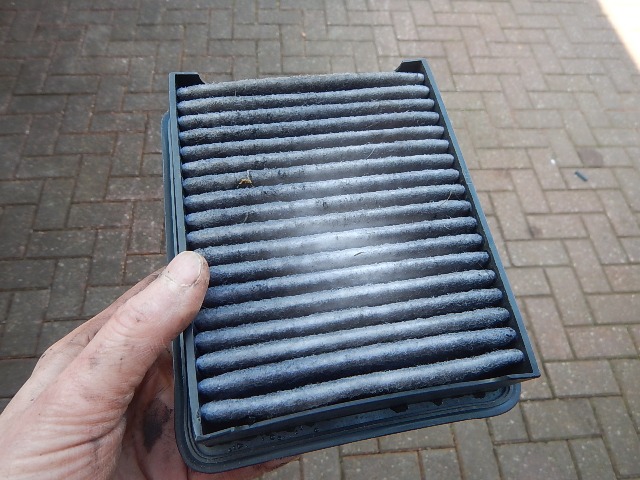

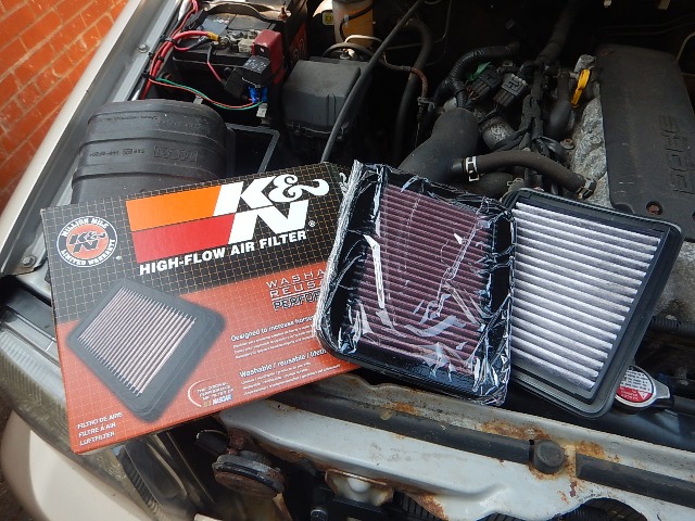

Next a K&N Filter was fitted...
This will be why some owners report better performance then?! :blink:

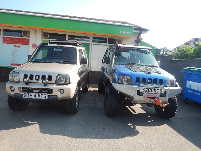

Park next to his big brother!
S200KYS has a 5" all suspension lift with 31"x10.5" Maxxis Trepador tyres, BT54VTS has a 2" trailmaster suspension lift and a 2" bodylift with 235/75/15s BF Goodrich All Terrains
