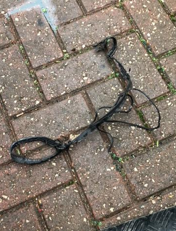

The Gold Jimny let me down last week
I was going to have my usual Wednesday off in the garage and needed some sanding disks from the local Screwfix on the Tuesday afternoon, with my member of staff due to finish at 6pm, I shot off at 5:30pm and... got half way there before the charge (battery) light came on and she then started running hot... a fan belt had gone
So I limped into Screwfix's nice secure compound car park and collected my bits and let them know I'd had to leave it there overnight... I than rang my daughter to pick me up as quickly as possible to get back to the shop...

The offending mangled belt

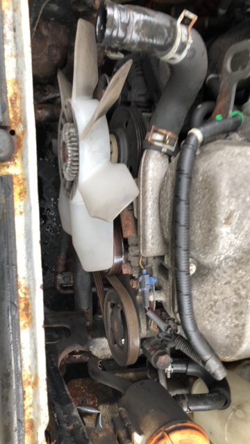

From experience - of watching / helping Brett change one of his on the side of the road once, I remembered it being easier to whip the radiator out to get to the belts, more room to work and easier to see what you're doing

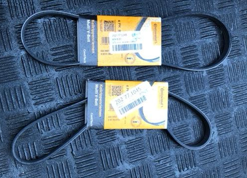

New belts ready to go on, figured I might as well change them both (and I also bought another set to go in the blue S200KYS too)

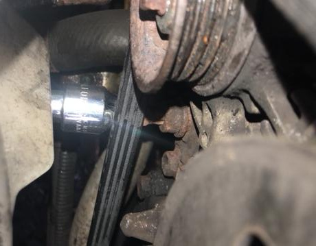

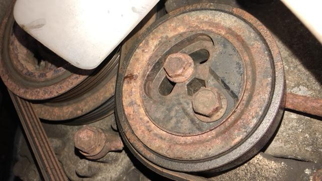

The tensioner needs to be loosened off to get to the second belt behind the first which was still intact,
NOOooo... good job (1) I wasn't doing this in Screwfix's carpark, and (2) I had my support network (the lads) on Whatsapp to talk to on the drive

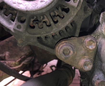

... is that a Torx bolt on the alternator swivel?!
With the old belt popped off I could then get to replace both the belts and tighten everyting back up again... With the new second (alternator and water pump) belt in place, that Torx bolt is tight under the belt?! A design flaw? Surely not...

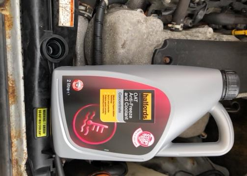

Refitting the radiator and pipes and refilling with a nice strong anti-freeze to water mix (50/50)

Great Job! But after reading all the debate in here about which coolant is correct, is pink OAT the right stuff? :blink:

That's what the registration number database pulled up and confirmed as right, as I went to the counter in Halfords with both types to ask what the difference was...
Dave
Replied by S200KYS on topic Dave's Gold (Beige!) Daily Driver
Max Headroom wrote: Great Job! But after reading all the debate in here about which coolant is correct, is pink OAT the right stuff? :blink:
