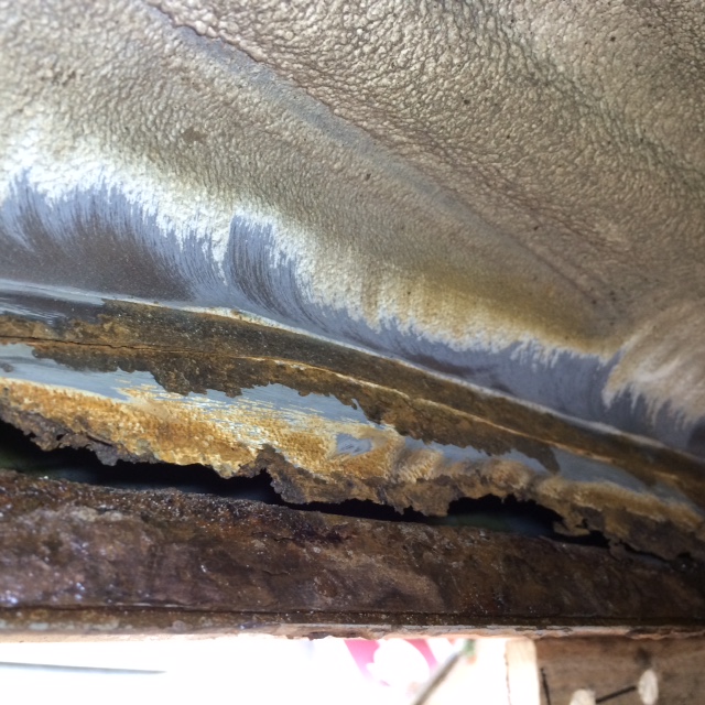

The Jimny failed it's MOT (annual inspection) on rusty sill on the driver's side -
So that needed a large patch seam welded into place... Sorted!

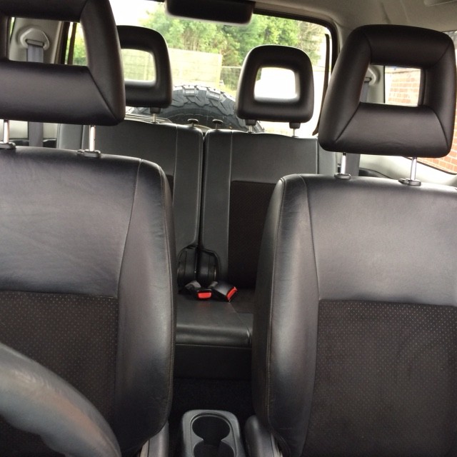

And last week, some leather seats popped up on here for sale, so they went in -
So, the gold / beige Jimny is nearly complete... not that they ever are?
