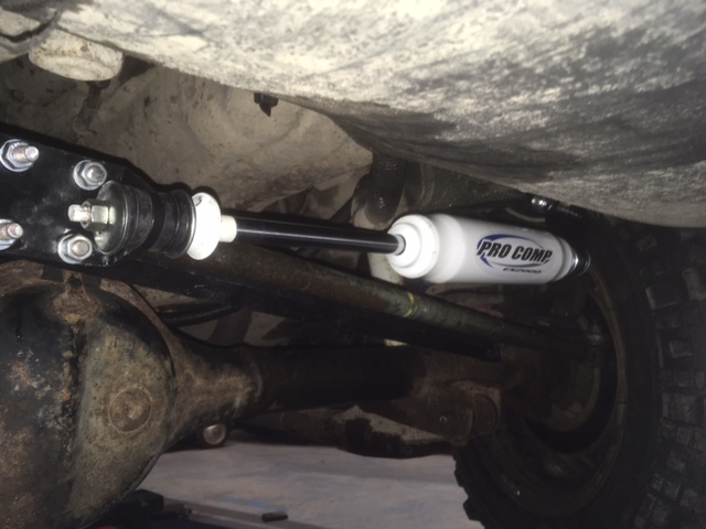

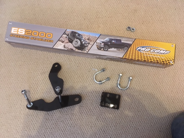

Today’s job was fit the steering damper, I had complained above about the over light steering, I did have my reservations about how much good the damper could do, especially as the kit is £86, but I’m glad I fitted it. If Martin offered me my money back to return the kit, I wouldn’t take it. The steering now has some feel to it, and when it hits a pot hole the car doesn’t feel like it’s going to jump in to the oncoming traffic! It’s no sports car, but it does feel a lot safer now, even at the heady speeds of 55mph.
I decide to Waxoyl that part of the chassis leg before fitting it - as it could become a bit of a rust trap.
Out of interest – What is the cruising speed that most people get, I’m running 205 simex style tyres, and it feels happy and could be driven all day at around 55mph (I was hoping for better!), it will go faster (but not much!)
The kit :
Fitted:
Phil
