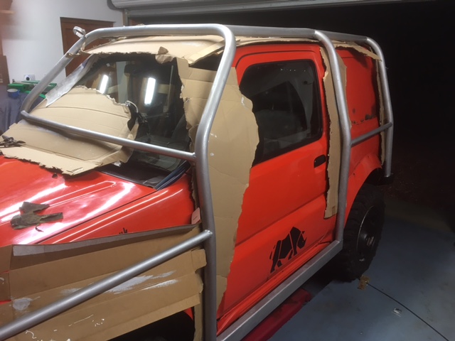

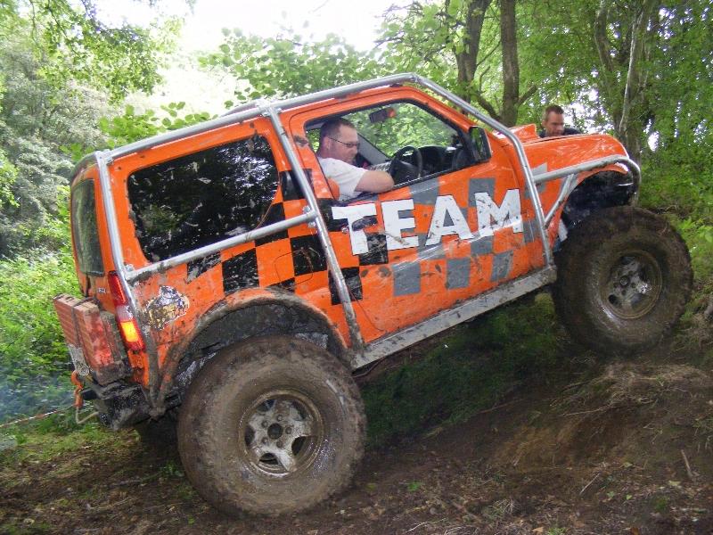

Looks like a very capable off roader. I've seen quite a few people extend their seats is this to give a better view of the road/off road or simply to suit people's different heights?

It looks cool and the silver cage is much better!
