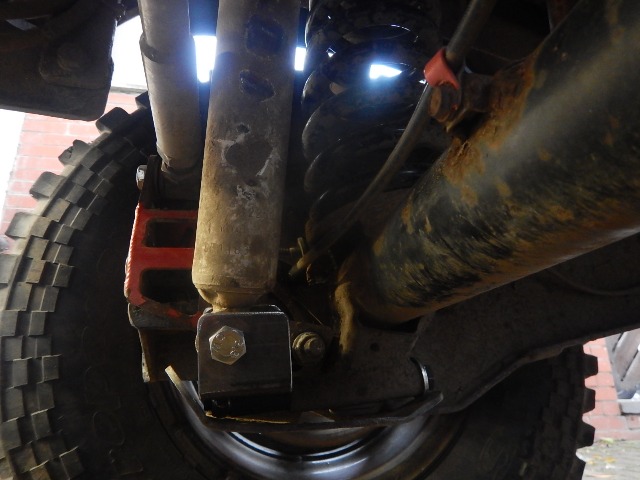

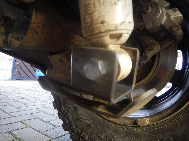

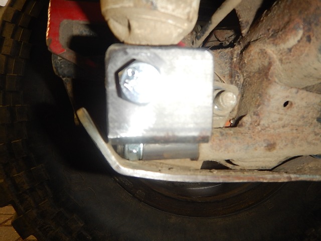

I know a lot of people on here don't like shock spacers... but I needed to make some custom ones for S200KYS today..
After fitting the new springs I noticed the shocks were too short! They are +4" ProComp ES1000's on the back, but the springs are that long that they were fully extended at rest, so going over speed bumps the back was "hopping" a bit...
I thought about buying longer shocks, but it's December and funds are limited due to the impending festivities, and besides, examing the shocks they had spring marks all up the back of them, so no use fitting new shocks for the same thing to happen, so I decided to knock up some shock spacers to get the Jimny ready for this Sunday's outing, a day-trip (!) to the Lake District!
So I made them offset so that the shock was relocated away from the spring...
Very much how Martin had them made when he first started selling these kind of relocators
Here you can clearly see the offset backwards, and the narrower mounting tube underneath the "U" shape of the relocator
And here you can see the shock relocated midway between the panhard and the spring...
You can also see the spring marks on the shock now it's been twisted 90 degrees...
And... you can see how much twist was on the bottom shock bushes, see the angle the bracket is sat at?!...
The brackets are un-plated / painted at the moment as I need them for the weekend... I'll get them back off next week and send them for plating, and order some new shocks after Christmas and get them re-fitted together...
