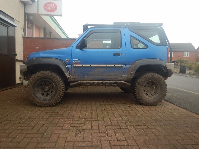

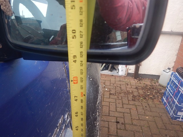

Being meaning to do this for a while...
Spring refresh 2017! :lol:

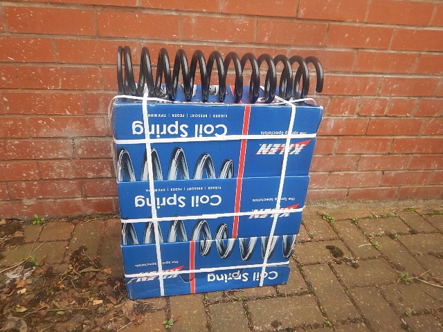

You'll remember I researched these springs on t'internet and believed they'd be a good match for the height and weight of my Jimny due to the length, number of coils and thickness of the wire used to make them... So here goes...
BEFORE - I felt that the existing springs had sagged a little in their two year life on my lilttle Jimny, so that's probably at least 24 rough greenlaning trips? Can't complain at that?
Reference height, this is all suspension lift and tyres (31")

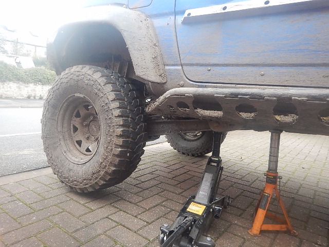

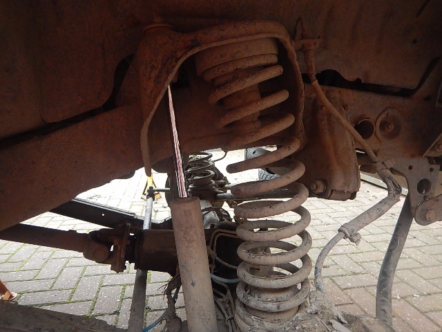

Out comes Big Jack and an axle stand at full stretch, plenty of articulation there then

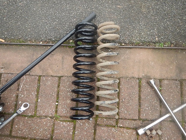

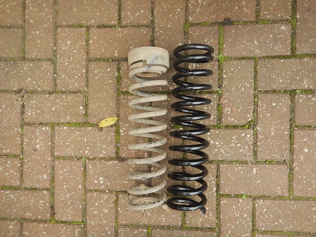

Ooh?! That's a surprise?! :ohmy: I'd figured the new springs would be a bit longer than the old ones and I'd have to cut a coil off the front and two off the back? But no, these are near as damn it the same length as the old ones (+3" front diesel springs from you-know-who). But these are wound even thicker, hence why I figure they'd be suitable for the weight of my notoriously heavy Jim' :lol:
So I fitted them as-is, no cutting...

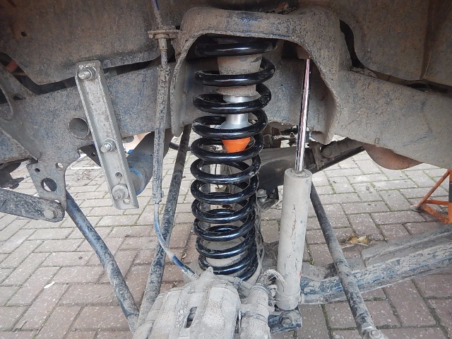

Now for the front then...
Again, these are +3" front diesel springs with one of my spring spacers on the top, to make the 4" lift up... I was surprised at the bow in the spring?

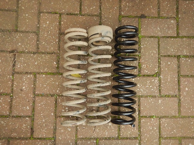

With the spring out, again, I was surprised at the length? The new spring looks to be sitting at the same height as the old spring plus the spacer?...
Reference the back to front springs then, that started at the same length (they were all +3" front diesel springs all round), so the front has sagged more than the rear, due to the weight of the engine and winch/bumper up front no doubt... Oh, by the way, I'm not moaning about the sagging, it's to be well expected on a truck like mine that sees monthly 'laning trips like we do... As I said it's time for a refresh, I'm not having a go at you-know-who

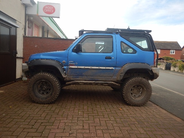

Front springs in then, on the original spring seats I'd stored in the garage (i.e. no spring spacers up front this time) and an extended bump stop finally fitted into the front springs, again, this could also have contributed to the front springs sagging...

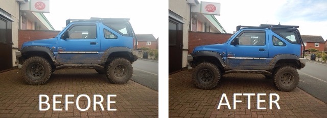

Back up in the air then, and it looks visually taller?

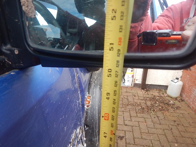

The tape measure confirms, almost 1.5" up (49" to 50.5" to the bottom of the mirrors)
Time for a test drive on the road then, and the next greenlaning trip on the 19th (Oldham to Holmfirth area) will confirm whether they ride right offroad... just hope they aren't too stiff! I've given the JImny a damn good rocking on the drive and it feels okay
