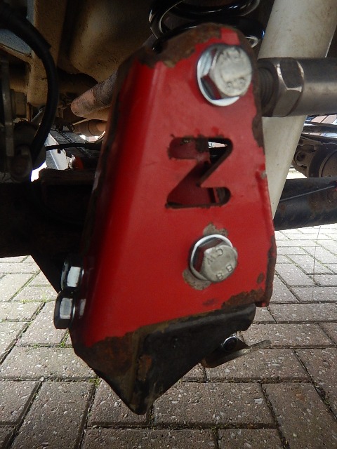

My Zanfi panhard bracket had started rocking on it's mount again... there is a fair bit of leverage on it though.
Found the 8mm bolts supplied with it had worked their way loose and were wobbling around in the slightly oversize holes, so I drilled them both out to 10mm and fitted new bolts and nylocs and then reassembled everything with new nylocs on the other bolts too...
