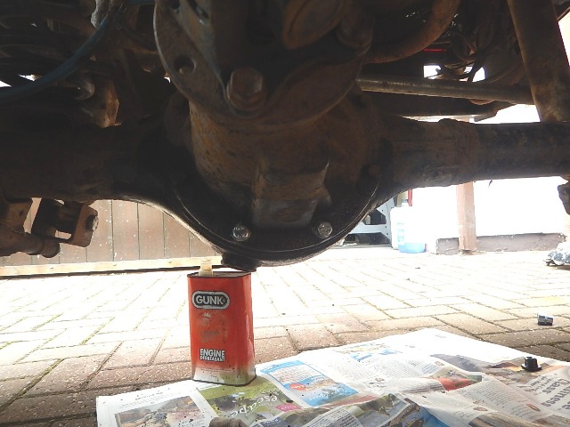

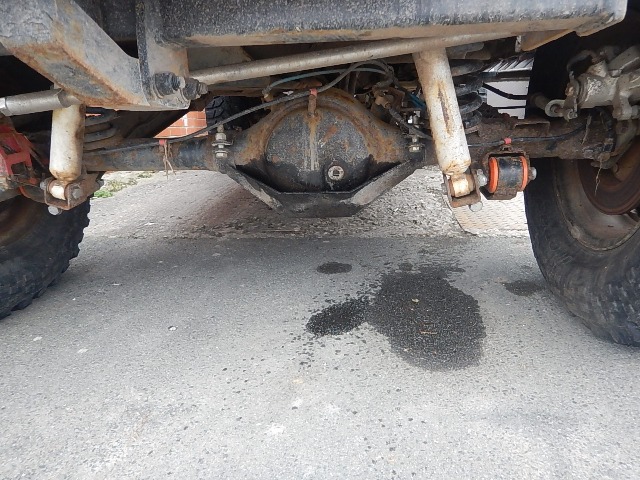

Bit of TLC before Sunday's greenlaning trip today...
New wiper blades so my co-pilot Alan can see where we're going!
And then an oil leak from the rear diff required my attention

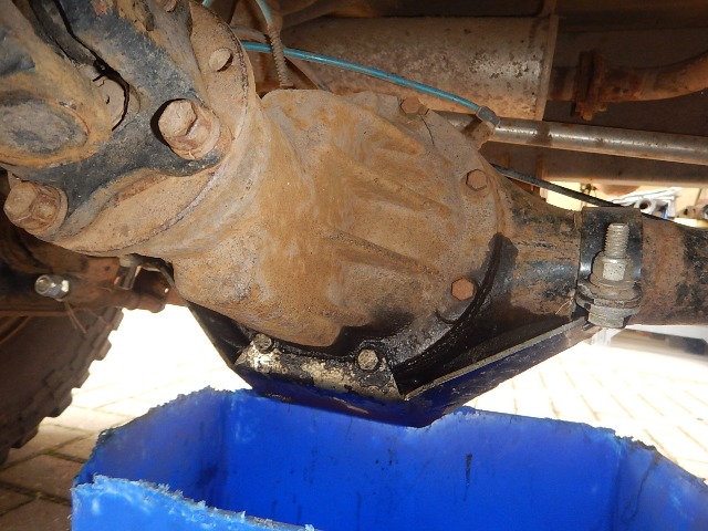

Hmmm, it appears to be coming from the bottom two diff bolts that also hold the rear axle's diff guard in place?

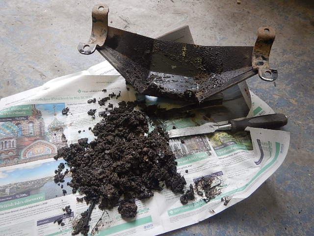

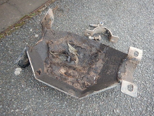

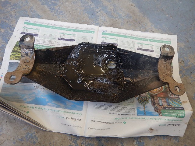

So I decided to take the diff guard off for a look, partly as it was full of mud and I struggled to get to the drain plug, so I unbolted the U shaped brackets that held it to the axle and then the two bottom diff bolts, making sure to get a tub underneath to catch the oil that then leaked out of the two diff bolt holes...
I could then get to the drain plug to clean it all out and drain the rest of the oil from the diff...
Yup, the diff guard is full of mud...
(the puddle of oil is just what leaked out when I had the two small boats out to get the guard off)
So, I fitted two new bolts at the bottom of the diff after dunking them in some sealant to cover the threads, and then refilled the diff...

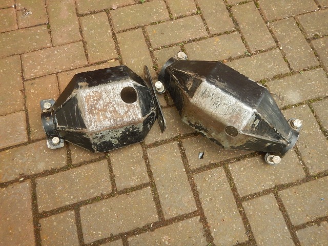

No leaks,,, Hmmm, I suspect the diff guard getting banged offroad has loosened the bolts on the diff, so I decided not to refit it... And then...
Took the front one off too...
Okay, some of my reasoning is due to a falling out with JimnyBits - I simply don't like his business principles, but won't go into details, so I've removed nearly all their products from my jimny - but also they just fill up with mud and reduce my Jimny's ground clearance... so they're off and in the for sale section of this fine site...

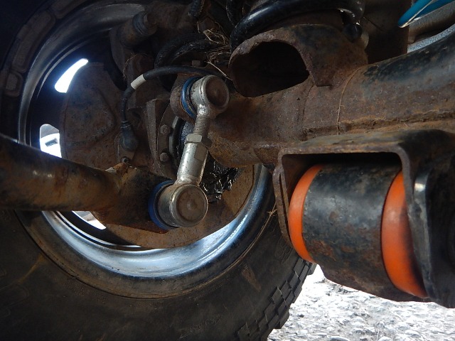

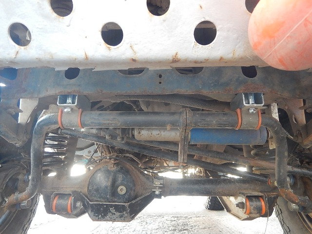

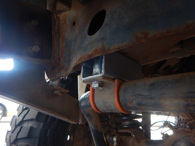

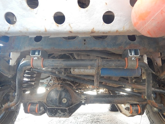

I fitted some bigger 'ZookBOB' (Me!) anti roll bar clamp spacers...
These are 40mm ones rather than the 20mm I originally made and fitted, so the droplinks are even straighter now -

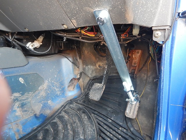

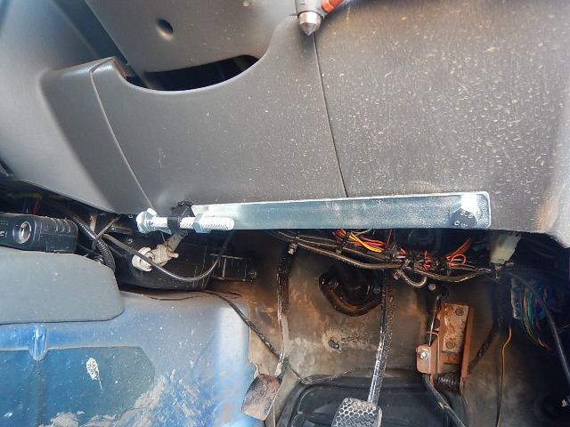

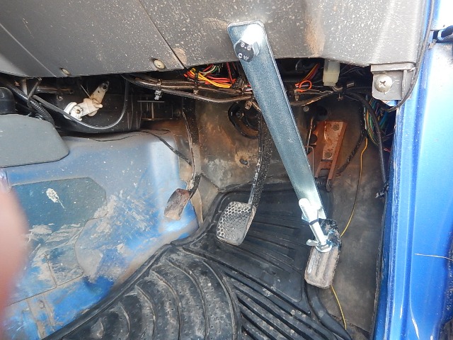

I also fitted, whilst developing, a hand throttle -
It simply bolts to the bottom edge of the dashboard, and then when needed -
Folds down and you set the revs to whatever you want with the wing-nut equipped foot that sits on the accelerator pedal, thus keeping your Jim' ticking over at say 2,000 rpm to recharge the battery(ies) after a bit of winching, etc...

Snap! This afternoons check round has shown the same problem from the bottom two bolts on mine
Replied by Riccy on topic Dave's "S200KYS" Jimny 'laner Build...
S200KYS wrote: Bit of TLC before Sunday's greenlaning trip today...
