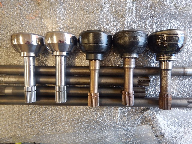

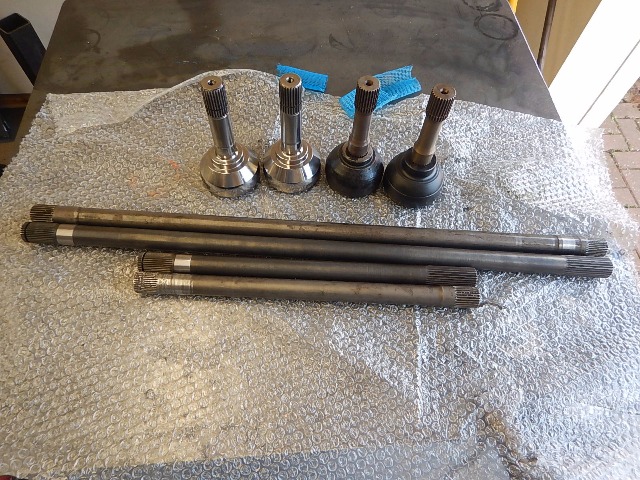

TG CVs on the left, RS CVs on the right, shafts are exactly the same lengths...
CV comparison... TG on the left, middle is a new RS CV, fourth one is another replacement but one he had left from the development stages, so appears a little shorter, more like the TG ones, and the fifth (right one) is the used passenger CV...

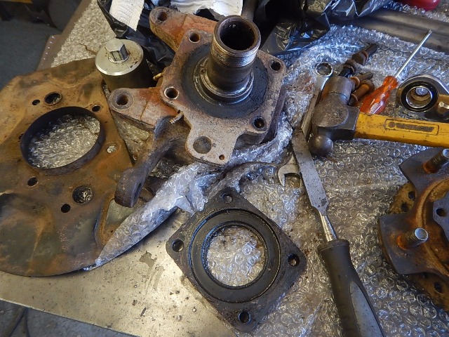

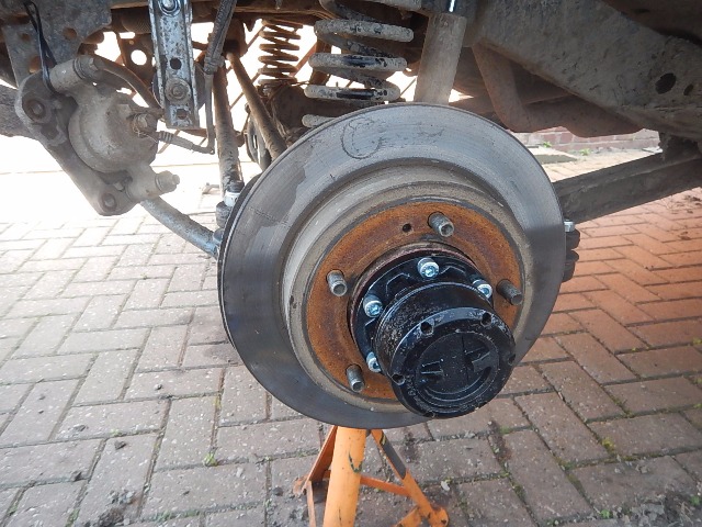

So, fitting the TG shafts, so I needed to remove the RS spacers from the hubs...

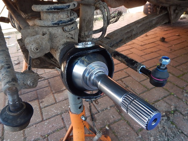

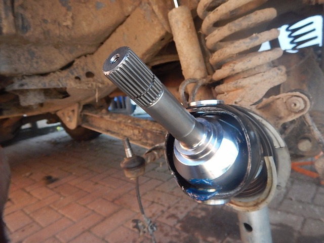

Surprisingly :ohmy: the TG shafts slid straight it?! :woohoo: You may have read that when Brett was fitting his they wouldn't go in easily, and I'd gone over to lend a hand and moral support, this was one of the main reasons I was swaying to refitting the RS shafts and CVs (and the fact that they had been in for 4 years and 48 trips, so I knew they would be good for another similar period), so I was very surprised when they slid in fairly easily?!
The driver's side going in, see how when it's angled up it just slips passed the end of the knuckle where the lower king pin bearing is?

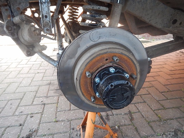

All reassembled. treated the free wheel hubs to a lick of paint while they were off, and a new set of mounting bolts...
The only things I'm missing, which I'll nip out and get in the morning, was shorter bolts for the brake calipers now the RS spacers have been removed, and LSD oil... So I'll finish reassembling tomorrow afternoon...

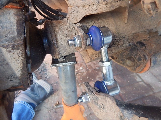

While everything was apart...
I also fitted some new ARB drop links... super heavy duty ones from SuperPro

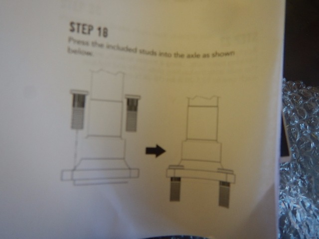

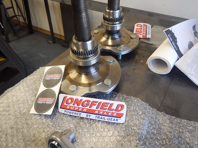

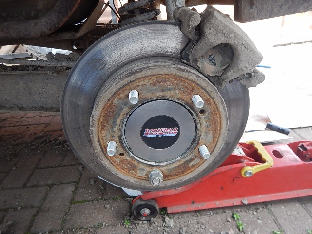

With the Trail Gear / Longfield front HD shafts and CVs installled... another parcel arrived from JimnyBits this morning... matching rear shafts!

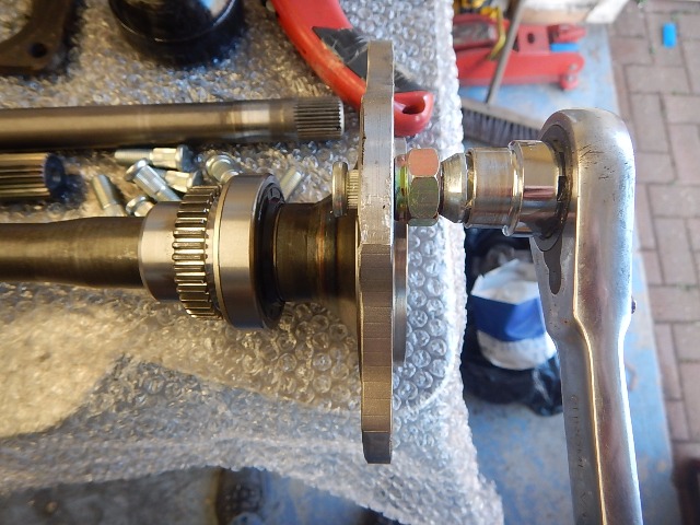

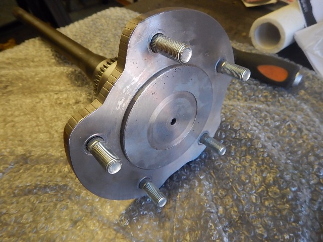

They arrived with the ABS pickup ring and bearings kindly fitted by Russ, but...
The studs weren't attached? The instructions just said "press the wheel studs into the axle as shown"?
So i pulled them through with a spare wheel nut, and a big nut used as a spacer...
Done! repeat for second half-shaft
All done and read to fit...

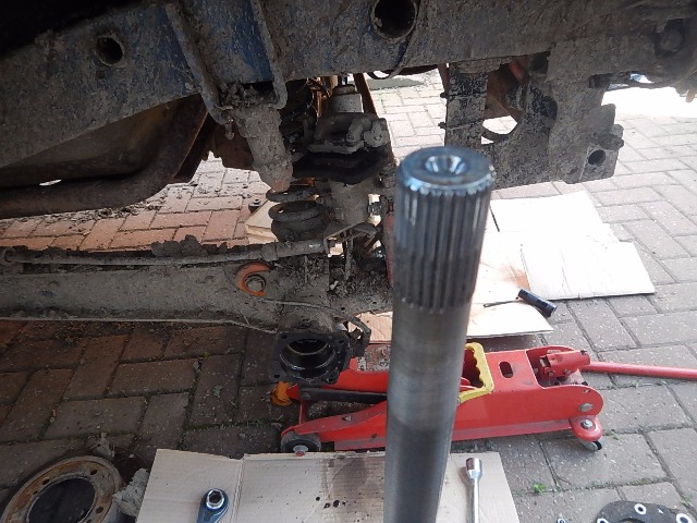

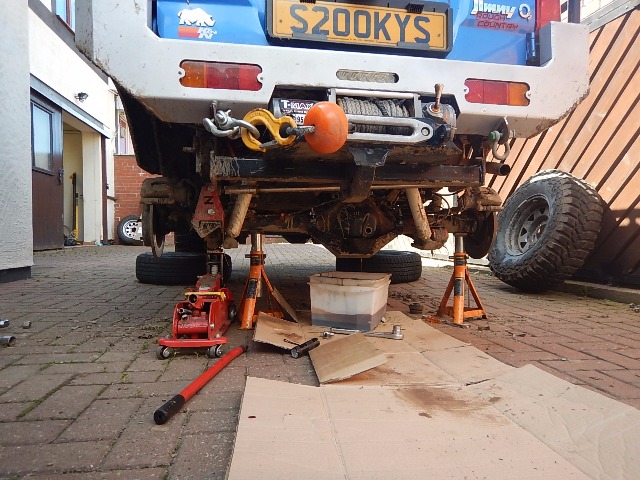

Up in the air, oil drained and ready to pull the standard shafts out...
Hmmm, they've faired well!
New HD shafts in!

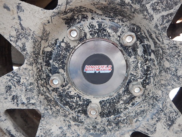

Nice shot of new axle shaft in muddy wheel

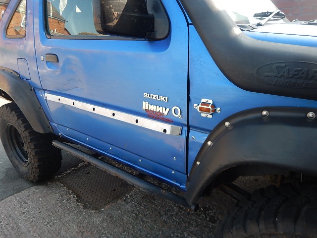

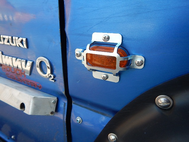

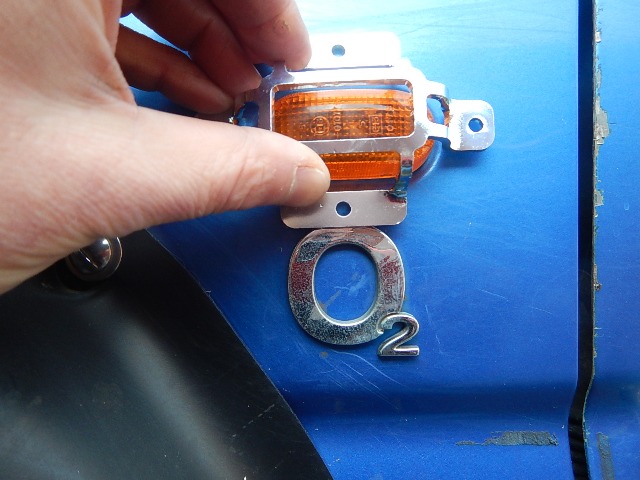

Some long awaited important parts came into stock at JimnyBits this week!
Armour-plated side repeater guards!
Got mine in zinc-plated colour to match the door bars - they are also available black powder coated too...
Ahh, whoops!
Soon fixed with a chisel and nail varnish remover!
Ideal for our Tight & Scratchy 'laning adventures!
