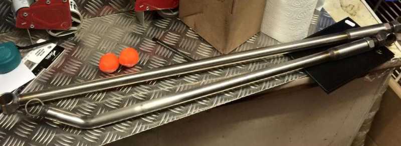

Ooooohhh... look what arrived this morning -
Custom 316 stainless steel panhards from ROCKWATT... the front one is kinked to fit around my Zanfi Dropped Pitman Arm "problem" * where it fouls on the existing panhard after it was also dropped using a Zanfi panhard relocation bracket *...
*they normally fit left hand drive vehicles to be fair, they are now working on right hand versions

11 Dec 2015 12:41 #158304
Replied by Daniel30 on topic Dave's "S200KYS" Jimny 'laner Build...
Very nice Dave and is that some new bump stops I see there too?

- S200KYS
11 Dec 2015 14:13 #158305
by S200KYS
Yes, well spotted, they're the "samples"... i.e. they'll be fitted to mine to "test" them...
Must be some perks to running B4V?

- S200KYS
11 Dec 2015 15:04 #158307
by S200KYS
Sneaked out for a quick look -
Perfect! Kinks down enough to pass the drop pitman arm when it's refitted, and out a touch to squeeze nicely past the diff pan...
ROCKWATT quality once again...!
In two minds whether to get the rods powdercoated as they are stainless steel, almost a shame to cover them?
