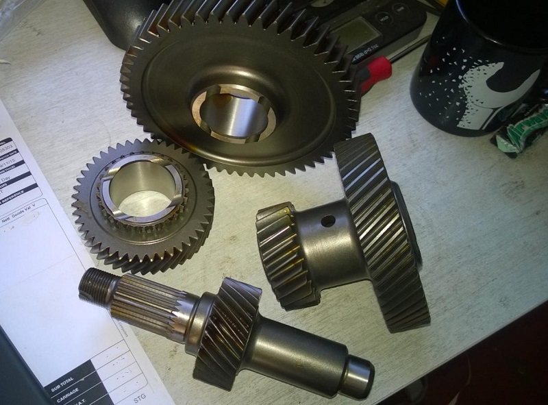

Oooh, look what's arrived at ROCKWATT HQ -
Brand new gears for my next transfer box incarnation... 4.87:1 on the low side and 1.63:1 on the high side... to match the 31"s that have just gone on
(A rocklobster, by comparison is 4.16:1 low-side and 1.5:1 high-side, so my tyres have gone 7% bigger 29" to 31" so the high side gearing needs to do the same, and the lower low range gearing will help offroad of course
"Happy Christmas Dave, with love from Dave" :woohoo: :evil: :whistle:

When will you install the new gears? Please let us know how they are compared to the 4:16 ratio
How much is a gearset like this one ?
Replied by TomDK on topic Dave's "S200KYS" Jimny 'laner Build...
S200KYS wrote: Oooh, look what's arrived at ROCKWATT HQ -
Brand new gears for my next transfer box incarnation... 4.87:1 on the low side and 1.63:1 on the high side... to match the 31"s that have just gone on(A rocklobster, by comparison is 4.16:1 low-side and 1.5:1 high-side, so my tyres have gone 7% bigger 29" to 31" so the high side gearing needs to do the same, and the lower low range gearing will help offroad of course
Nice
