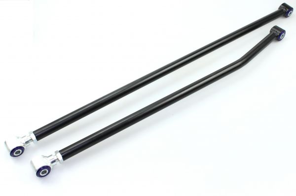

I don't think it would make any difference. Just out of interest have you measured the drop on the bracket and pitman arm?
It's been fettled just a tad.
The topic has been locked.
- S200KYS
20 Nov 2015 06:58 #156691
by S200KYS
Yes, the 'kink' is the wrong way
Mine really needs a kink the other way to go under the drop pitman, not around it...
... enter ROCKWATT, with the offer of making a custom one to suit!
I'll be measuring for it on Sunday...
Yes Jezz, both the panhard drop bracket and the dropped pitman arm are approx 75mm / 3" drop... I've no doubt they would work on a left-hand drive vehicle as in Zanfi's photo, but the right-hand drive seems to be a little different!
