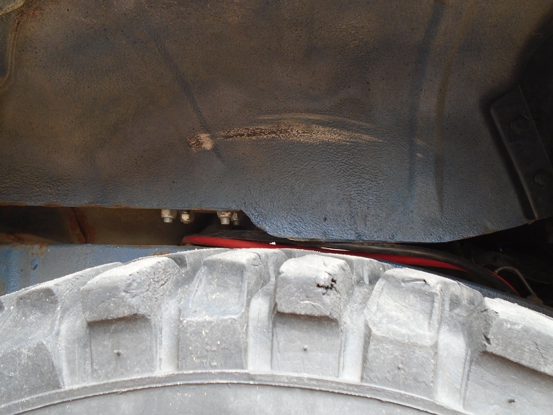

Replied by X8GGY on topic Dave's (Bits4Vits) Jimny 'laner Build...
As said earlier... during a checkover today before a 'laning trip on Sunday, I noticed this -
A worn area inside the OSR wheel arch?
On further investigation -

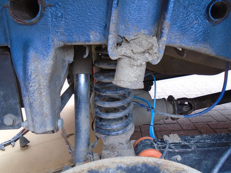

The bump stop's black rubber cone was missing! :ohmy: Just the bump stop spacer remains and the screw-in base, but the bonded in rubber cone has gone?! LOL :laugh:
Replaced it for now with one stolen off the EX-Jimny... (you can see it lying on the cardboard with the over-centre plumbers pliers)

It's funny this has come up, I've just made some two inch spacer's too weld to that Axel to limit the up travel.
It's been fettled just a tad.
