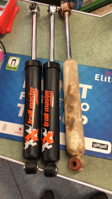

My ProComp rear shocks have taken a battering (still running AVO shocks on the front), I emailed JB for a price for their 'Black Raptor' brand ones (which look just like AVO ones) but never got a response, but in the meantime I found these -
Some trailmaster shocks I had returned to me when I was a dealer for them a few years ago, from what I recollect the customer complained they squeaked a bit, but that won't bother me, I won't hear them over all the other noise

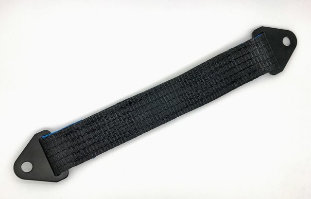

Limiting Straps from Damar Webbing, who I've used many times over the years
To stop the shocks drooping to full stretch and the piston hitting the top of the tube...
And these are due to land tomorrow -
