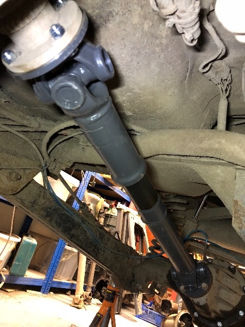

I then fitted the rear prop, photo above...

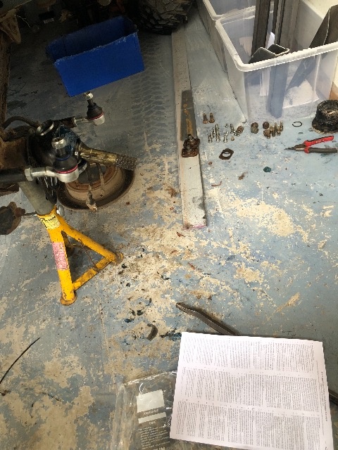

And then began reassembling the front axle, up to the stage of getting the hubs back on, but have left that for a fresh start on Sunday...

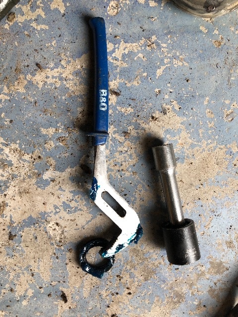

My two specialist tools! Half an over-centre pair of pliers serves as my oil seal removal tool, and an extension bar with a suitably sized socket on is the exact size for tapping the kingpin races out of the swivel ball, and then doubles as the right size to tap the oil seals home too...

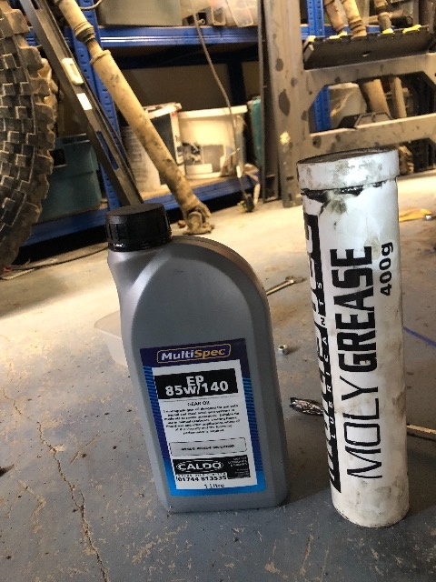

Just before knocking off for the day I drained and refilled the transfer box... nice thick oil and some moly grease scooped in on a big screwdriver...

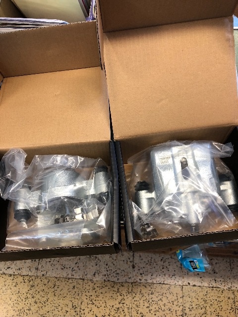

So that leaves Sunday to get the rear shafts back in when they get back with the bearings and ABS collars on, finish rebuilding the hubs and then the new free wheel hubs, hopefully the new front brake calipers will turn up from Germany by the weekend too...

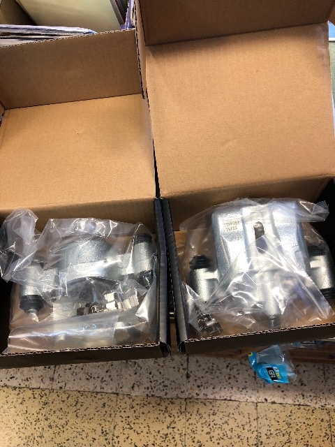

- S200KYS
17 May 2018 12:20 - 17 May 2018 12:21 #192766
by S200KYS
Last edit: 17 May 2018 12:21 by S200KYS.
The topic has been locked.
- Posts: 9946
- Thank you received: 1988
17 May 2018 14:50 #192770
For solid or vented discs?
- S200KYS
17 May 2018 17:24 #192774
by S200KYS
Just normal ones
