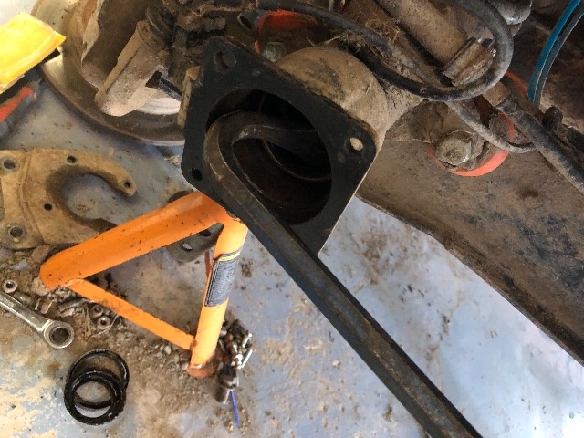

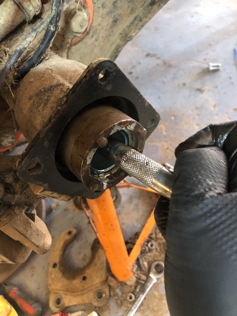

Have you a home-made tool for removing the Oil Seal on Rear Shafts/Axle and a home-made tool to put the new one in??
... I always struggle!!

Slide hammer with an L bracket on the end to get em out, big socket and rubber hammer to refit
