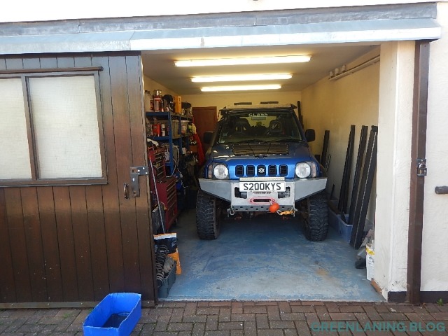

Riccy - thanks, I'll hopefully see what's wrong with it this afternoon, off 2-6 so it's having a wash at the moment at the hand car wash around the corner, tidy ZookBOB stuff out of the way in the man cave and then get the Jimny in and quickly stripped to see what needs sourcing to hopefully make the repairs in time for the Punch Hunt...

30 Apr 2018 11:51 - 30 Apr 2018 22:55 #192301
Replied by X8GGY on topic Re:Dave's "S200KYS" Jimny 'laner Build...
Not sure what's gone yet...?
I sneaked out to drop it off at the hand car wash around the block, and they delivered it back to me... ready to get it in the man cave
So I should know what's wrong pretty soon...

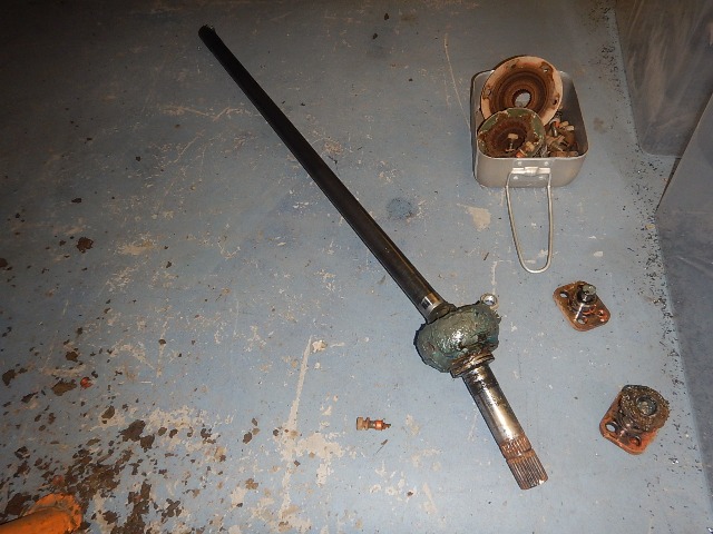

30 Apr 2018 15:02 #192303
BUGGER!...
BOTH front shafts and CVs are intact... that means... it's the diff?! My one-off machined to fit Vitara LSD (Limited Slip Diff).
Time to whip the diff out then?
