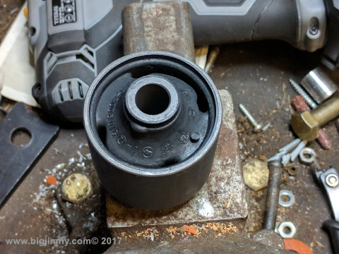

As mentioned before, the axle end bushes have slots cut in them and Suzuki provide a diagram of how the bushes should be orientated.  The first picture is the diagram and the second picture shows the slots in the bush. It is quite difficult to get them perfectly aligned but I work on the principle that close enough is good enough.
As you can see from the pictures below, the press only required 3 tonnes to put the bushes in. I managed to get the slots orientated fairly well although there was some movement early in the pressing. The last picture shows the axle end bush.
