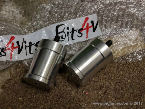

Dave over at Bits4Vits does a great set of turned aluminium bump stop extensions, these arrived nice and promptly in the week. The bump stop extenders are threaded to take the old bump stops and to screw into the original mounting position.
