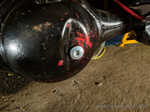

 Finally for the axle I fitted a new Drain Plug, filled it to the correct level with the correct oil and fitted a new Filler Plug and Gasket from the BigJimny store.
 And here she is, sitting on her own wheels and axles once more. Now on to fit the new springs to the front.
