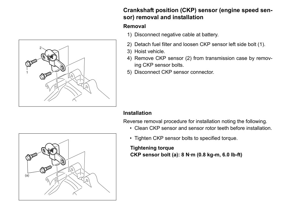

The K9K has a crankshaft sensor, the same as the petrol engines, and we usually start here if there are no fault codes as loss of crankshaft signal is the same as the engine stalling, so it isn't flagged as an error.
This will light up the dash as the car just thinks the engine is stopped with the ignition on.
I'd just swap it out and hope for the best, it is cheaper than paying a garage for diagnostics and you can check the wiring to it at the same time. (It is often called a CKP sensor)
EDIT: top of the bell housing.
