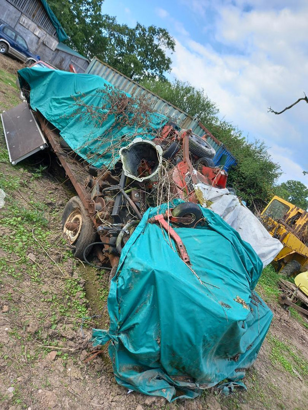

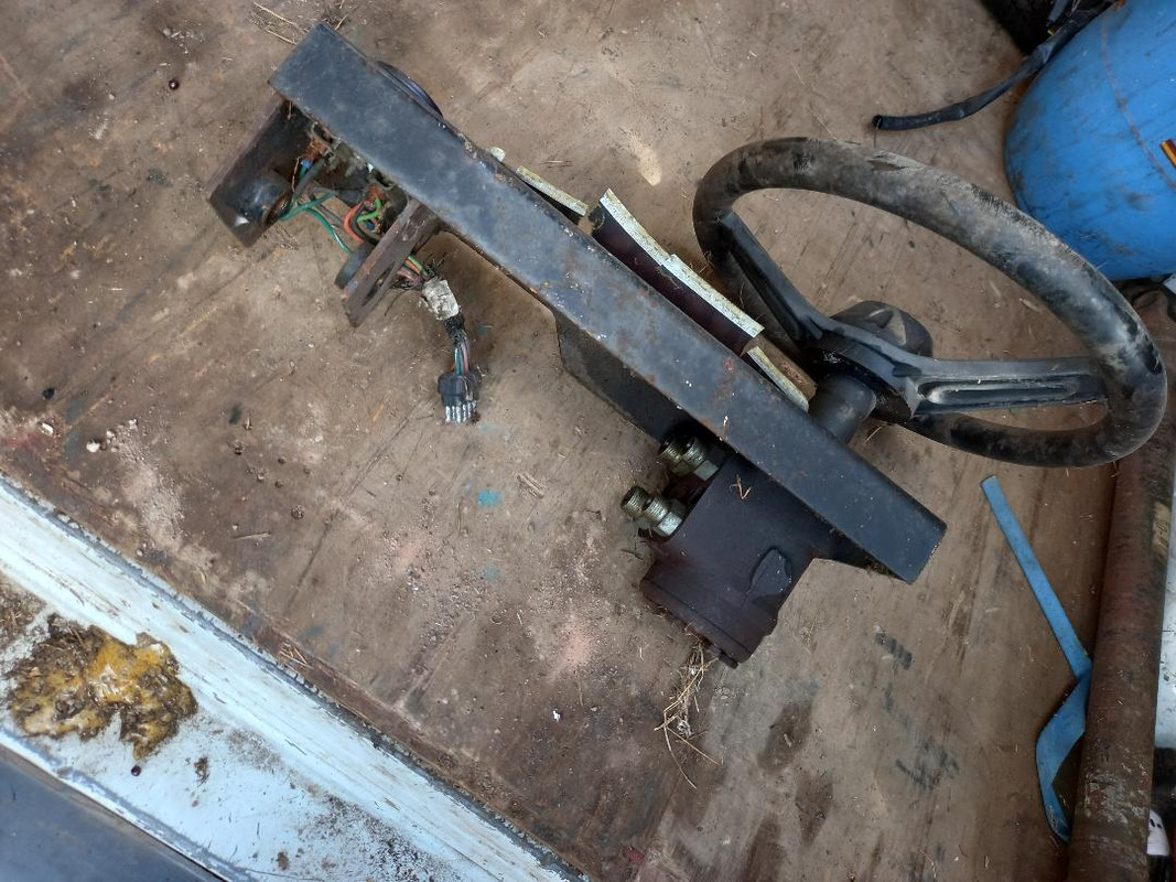

i went down the farm yesterday to have a rummage through the scrap looking for anything useful as you do and found the remains of a commercial mower that had hydraulic steering so i nicked that
so do any of you clever folk know how much pressure a power steering pump makes will it work a hydraulic ram ?
