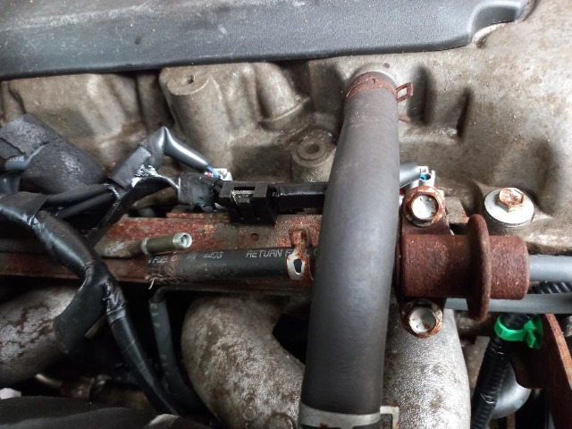

right time to get a move on here, need to get this one running, i have no check engine light but it refuses to start
ive pulled off a fuel hose on top of the engine when i turn the ign key on i expected the fuel pump to run for a few seconds to bring the pressure in the line up for the injectors, no fuel comes out of this hose/pipe should it ? i cant hear the fuel pump run can you normally ?
is there access to the fuel pump under the back seat ? anyone ?

In the picture you have the return line disconnected. Its not letting fuel out because the solenoid before it will be shut. Try putting a vaccum to the little hoop of pipe before the solenoid, otherwise the feed line is down near the starter motor im afraid. The filter is in the tank also.
To access the pump you need to drop the tank out or cut a hole in the floor.
Hope that helps
Hope that helps

Usually you can hear the pump prime. Unfortunately there's not an inspection plate you have to lower the tank.

the feed pipe down by the starter looked harder to get at lol, i will try that pipe next then if no joy there then its time to cut a hole under the back seat i guess
thank you
thank you
i cant hear a thing but then im deaf lol, will investigate further
