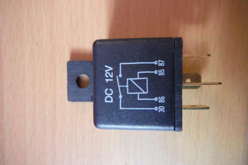

How to wire spotlights to work on the high beam.
Relay wiring diagram
Wiring diagram was made with help from Renard 38.
Link to how to fit spolight on soft top www.bigjimny.com/index.php/forum?view=to...=8&id=10688&start=48
