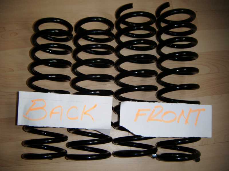

Don't you mean one of the front springs is longer, if so It go on the drivers side.

I cant remember haha maybe it was the front
So the back springs should be the same length?

interesting. the old jimny it was on used to lean a little to the left. i will check it out this weekend i am pretty sure there was a difference...maybe a manufacturing fault.
