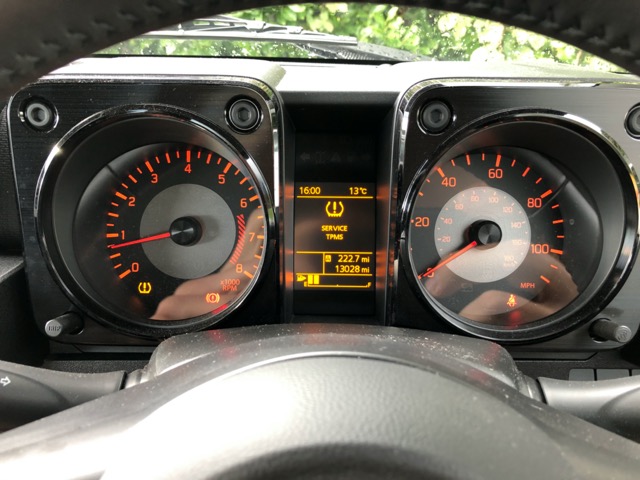

10 Oct 2020 15:41 - 10 Oct 2020 15:48 #229004 by DAGZOOK
Replied by DAGZOOK on topic Re:My First ZOOK!
Thanks Martin,
I've tried this several times with no noticeable change in the way the error lights are displaying.
My TPMS lights displayed in that 'continuous flashing' motion after driving around for a few miles with the new wheels on. Running that door switch procedure didn't seem to change anything (visibly anyway). It would seem this procedure will only work whilst the factory wheels and sensors are currently fitted? As I've already swapped my wheels over and the error has been flagged up on the dash by natural driving, I assume it's already forgotten the original Sensor I.D's.
I also had the TPMS bypass module in 'learning mode' right beside me and it didn't recognise it. I feel like I've got a faulty unit, depending on the outcome with Iron Gate next week, I'd definitely be up for posting you my module to see if it's displaying and I.D's at all.
My dash looks like this (TPMS lower left light and central warning triangle are flashing every second in an alternate pattern).
Last edit: 10 Oct 2020 15:48 by DAGZOOK.
