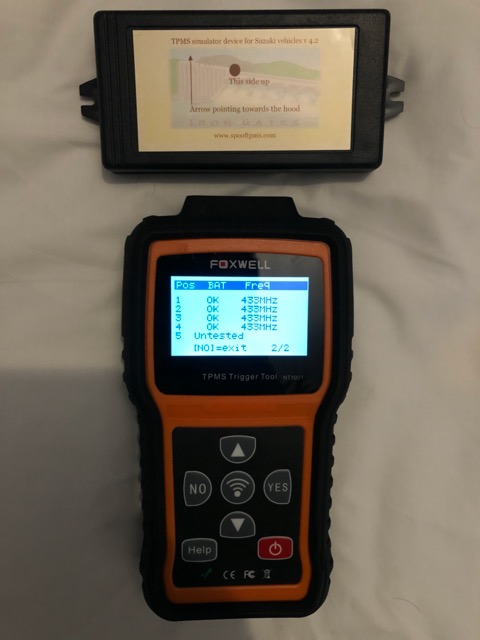

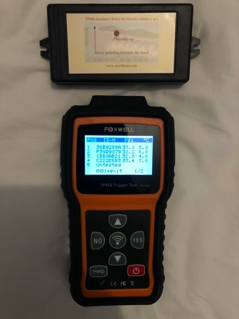

TPMS UPDATE:
I had the same difficulty with the corded version, despite many attempts to synchronise it IAW the Iron Gate instructions. I reached out to Martin for some advice as I was at a loose end. A huge thank you to Martin who's provided background support to me from the beginning. He kindly sent me his TPMS activation/reading tool which I used to aid my review for you all.
This morning I had success!!! The TMPS error light has now disappeared and seems to remain so when the car is restarted. In the end it was the battery device that I utilised, because it was that device that I was able to test away from the vehicle to ensure it was transmitting I.D's.
I'll try and summarise the steps I took in order to get the device to work correctly:
1. With the Iron Gates unit inside the house away from the vehicle, I used the Foxwell TPMS reader to detect all four 'Dummy' I.Ds. The Reader successfully picked up four 'dummy sensors'. Which gave me comfort that I didn't have a duff device. (See attached photographs).
2. I then checked the Jimnys ECU for any TMPS fault codes, none were displayed. (I suspect perhaps you need the SUZUKI software to access this part of the ECU as the OBD 2 diagnostic kit didn't seem to scan that particular function.
3. I repeated the 'manual' TPMS synchronisation step whereby the door button is pressed in sequence to force the TPMS system into 'learning mode'.
4. Within 180 seconds of doing this I then activated the 'Dummy I.Ds' whilst sat inside the vehicle. This was unsuccessful and the light didn't reset.
5. Finally one last hoorah, after doing the above I placed the TPMS unit (battery operated) on the back seat pushed into the back rest and bottom seat gap (same location that I've used consistently). I took the Jimny to a quiet road, placed it in calibration mode and drove for approximately 1.5kms where to my disbelief the TPMS error light disappeared.
6. I then pulled over and restarted the car to check whether or not the light came back on again. It didn't SUCCESS!!
The only variable here is the fact that I manually activated the bypass unit's TPMS I.D's before repeating the Iron Gates instructions. I did this within the 180 second window specified after conducting the manual door button reset procedure.
I had tried that exact same route dozens of times before with no success using the same driving and calibration techniques. It's a shame there's no smoking gun here, but ultimately, it's not realistic to expect every customer to have access to a TPMS reader to achieve what I've done above. I can't whole heartedly recommend the Iron Gates By-pass unit because of the difficulty that I've had setting it up. However with perseverance and MUCH trial and error, the system seems to be working for me.
