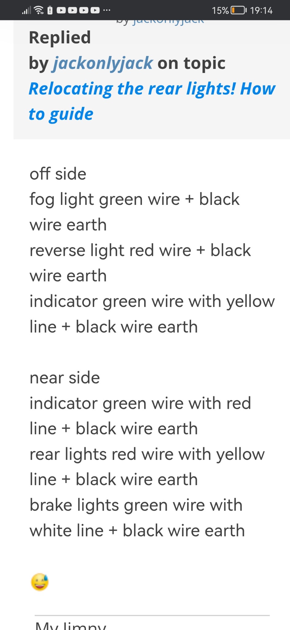

I’ve just noted that neither rear brake light is illuminating though the central brake light bar is working. I wonder if something was disturbed and/ or not properly reconnected last time the bumper was removed by the welder. Are there any wiring connectors fitted specifically for removing the bumper or is there likely another issue? While I’ve not studied it on the car yet I’ve similarly not come across a wiring diagram for the car to assist in working out the wiring colours. Is there one available somewhere?
1999 T registered Jimny. Early G13BB SOHC engine.
24 Nov 2025 19:16 #262898
Replied by jackonlyjack on topic Repair or scrap / break
The following user(s) said Thank You: Paul4A
