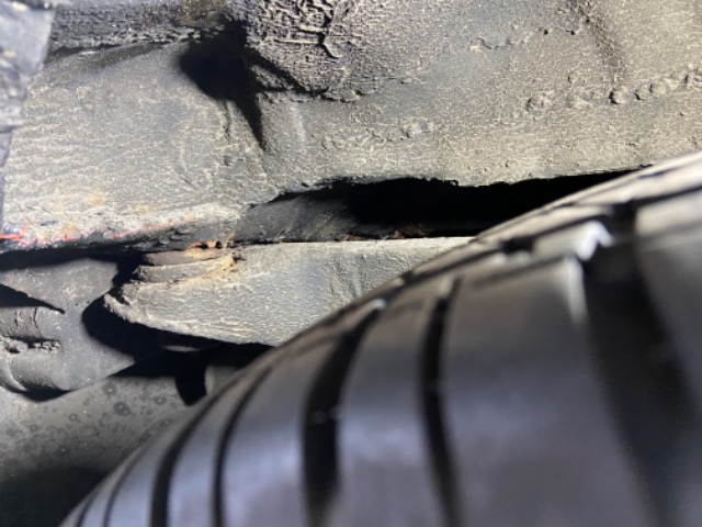

As a Jimny update, we’ve had a banging noise at the back end for a little while, occurring when going over poor or poorly repaired road surfaces. We’ve not been able to trace it so far, but, a garage today said they thought it was the rear body to chassis mountings. The receptionist initially told me it was the bushes but when we later visited the mechanic thought it may be body corrosion around the mounting point, and it might need the body lifting from the chassis to repair, though they wouldn’t do welding themselves. That’s a huge job and might be terminal for the car. I’ve this photo of the area. Is this something that is weldable without removing the body?
It would be a shame to lose it at this point and I’ve done a fair bit of wax protection underneath this year.

Replied by Lambert on topic Repair or scrap / break
Hard to say from that angle but it is usually the case that welding usually needs to get worse before it gets better, you never really know until you start peeling back. That said I would be inclined to try and keep it going it being an early one.

Does anyone kindly have and can post, or can share a link to where I can find, an exploded diagram of the rear bodywork construction around the point shown in the photo posted above. I'm trying to understand what's going on and what the challenges will be.

I have seen a floor pan on eBay
here
and also a back seat floor panel here
but I am struggling to see how my photo from under the rear wheel arch relates to those items, and how they relate to each other and what order they are fitted. Some guidance on this would be very much appreciated.
