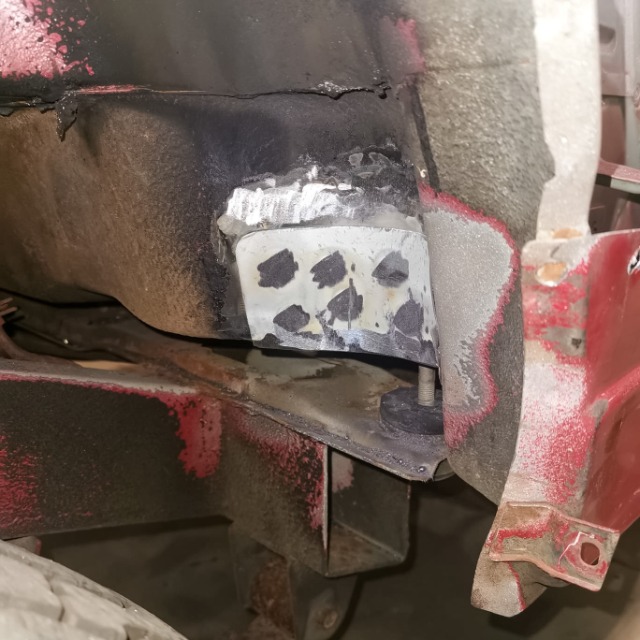

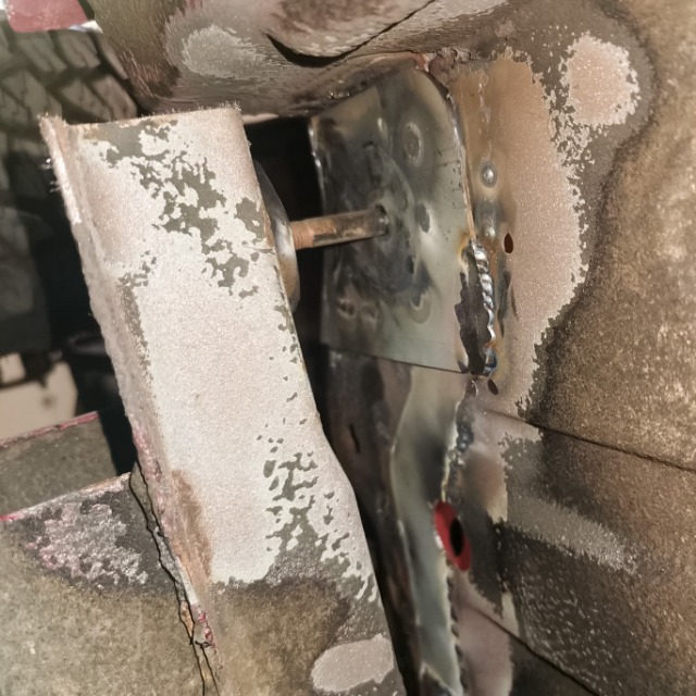

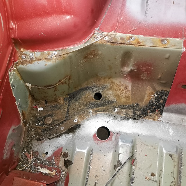

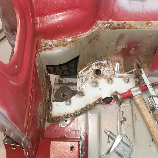

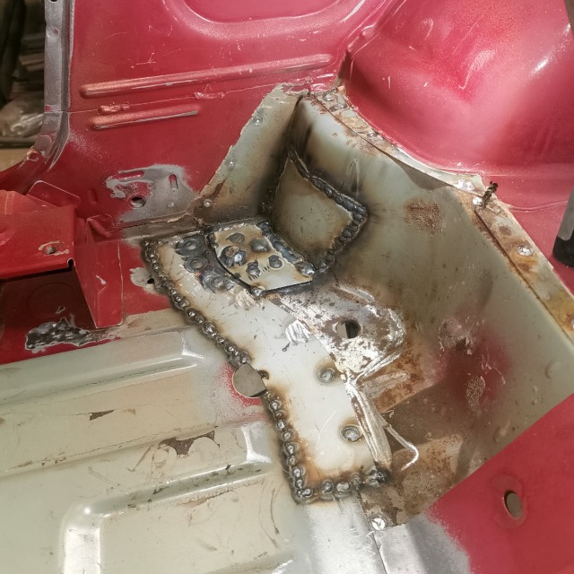

30 Nov 2024 18:47 - 30 Nov 2024 18:48 #258571
Replied by mlines on topic Repair or scrap / break

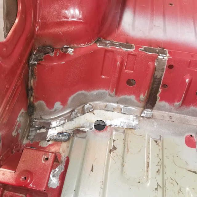

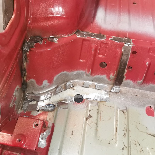

Not quite the Jimny you have, but a previous generation although the concept is the same.
First the top inside layer is removed
Then a hole is opened up to reveal the mount
Then plating is added
Then the hole is patched up
And the original top panel is fitted back
And then its gone!
And then its gone!
