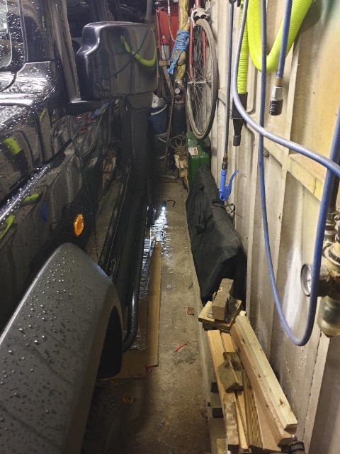

It was made from left overs from my big awning, but basically a camping/hiking tarp to cut to size.
1 meter of Kador strip and some Ally C-section these are the Poles I have.

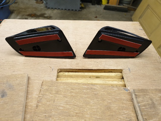

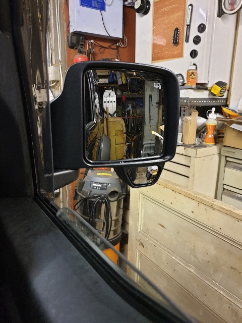

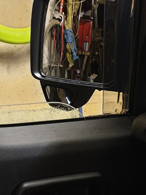

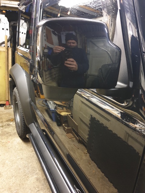

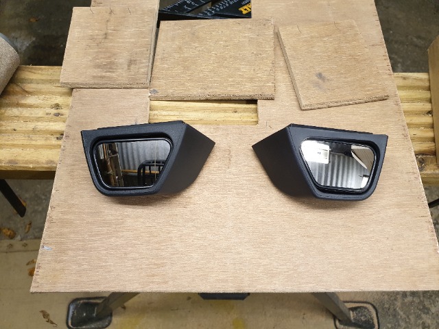

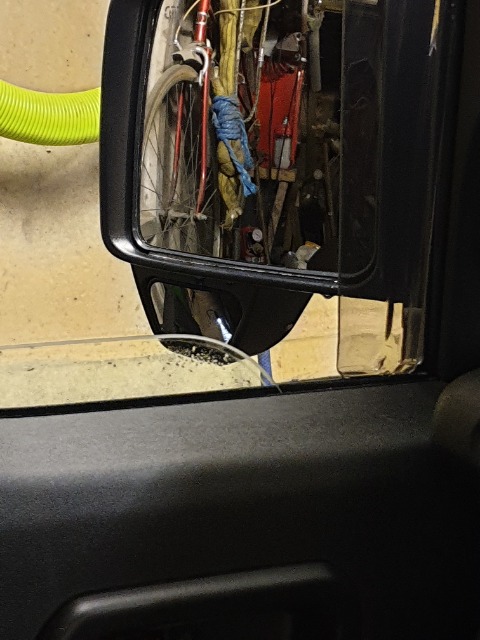

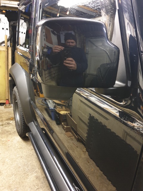

Blindspot mirrors came today, not quite the same as the OEM one fitted to the Japanese market but a good match.
Got them from Cartist01

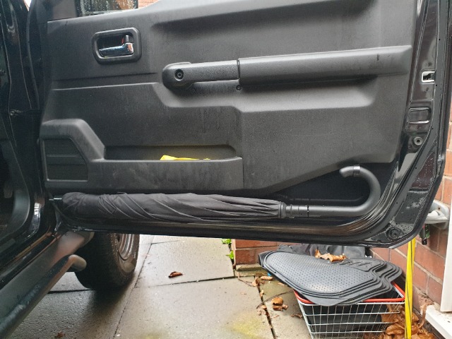

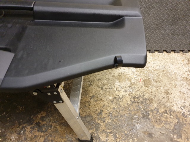

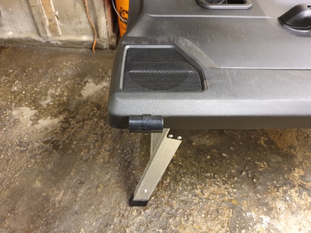

Another cheeky little storage mod. Got to admit I pinched the idea after seeing it on another group. Brolly fits perfectly and doesn't get squashed when the door is shut.

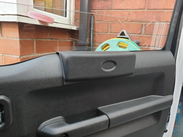

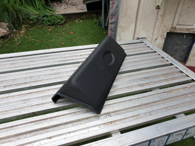

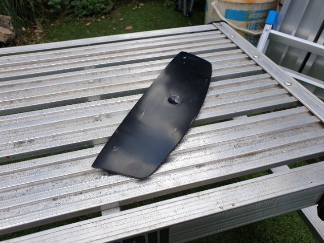

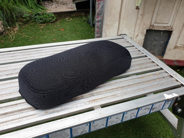

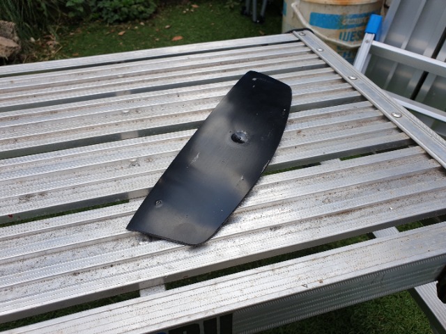

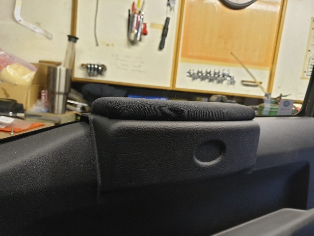

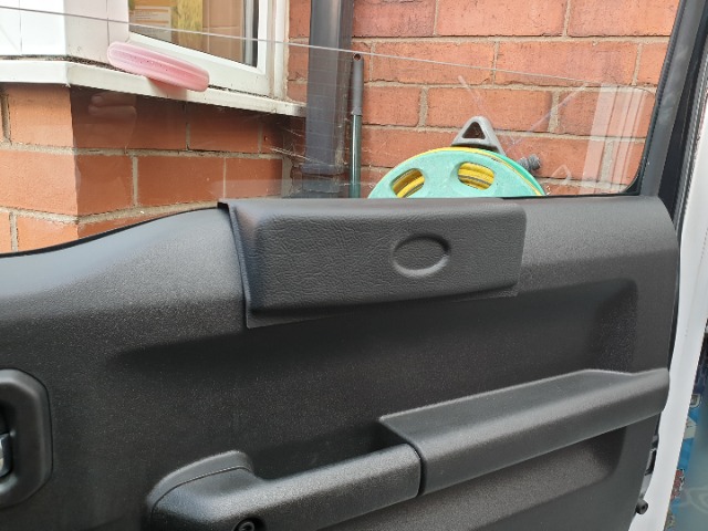

A nice little addition for longer/motorway journeys. I had spotted this MUD Defender armrest and thought the profile looked similar to the Jimnys door card.
MUDSTUFF
I trimmed 17mm from the lip that hooks over the door top. (Defenders mustn't have an internal weather seal)
Luckily I had a damaged centre arm rest, that I'd kept (never throw anything away )

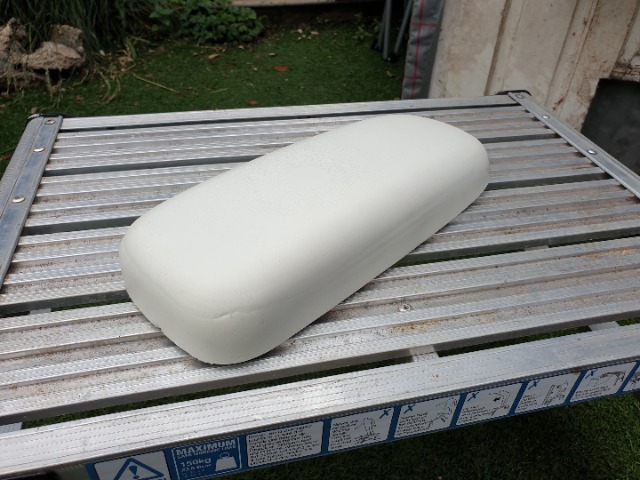

Fabric removed and you have the foam padding.

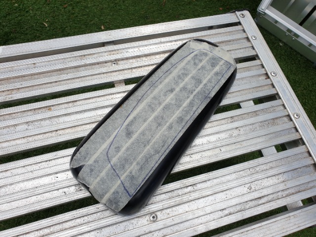

Mark out the plastic shell to suit your template.

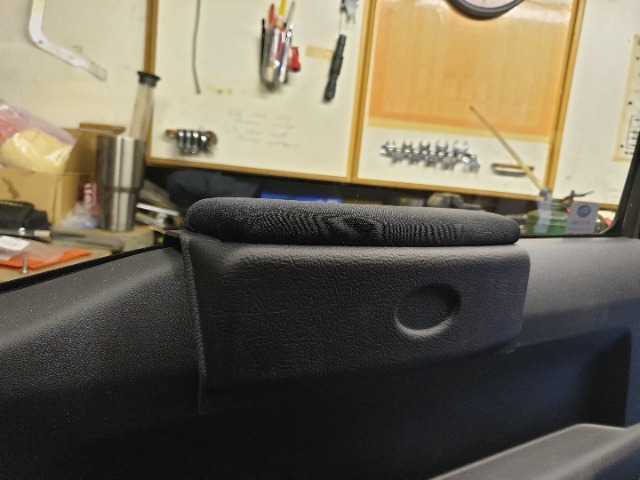

And cut to size. Then cut the foam padding to size and trim with the fabric removed earlier.
It provides a much more comfortable elbow rest when on long boring roads.
MUDSTUFF
