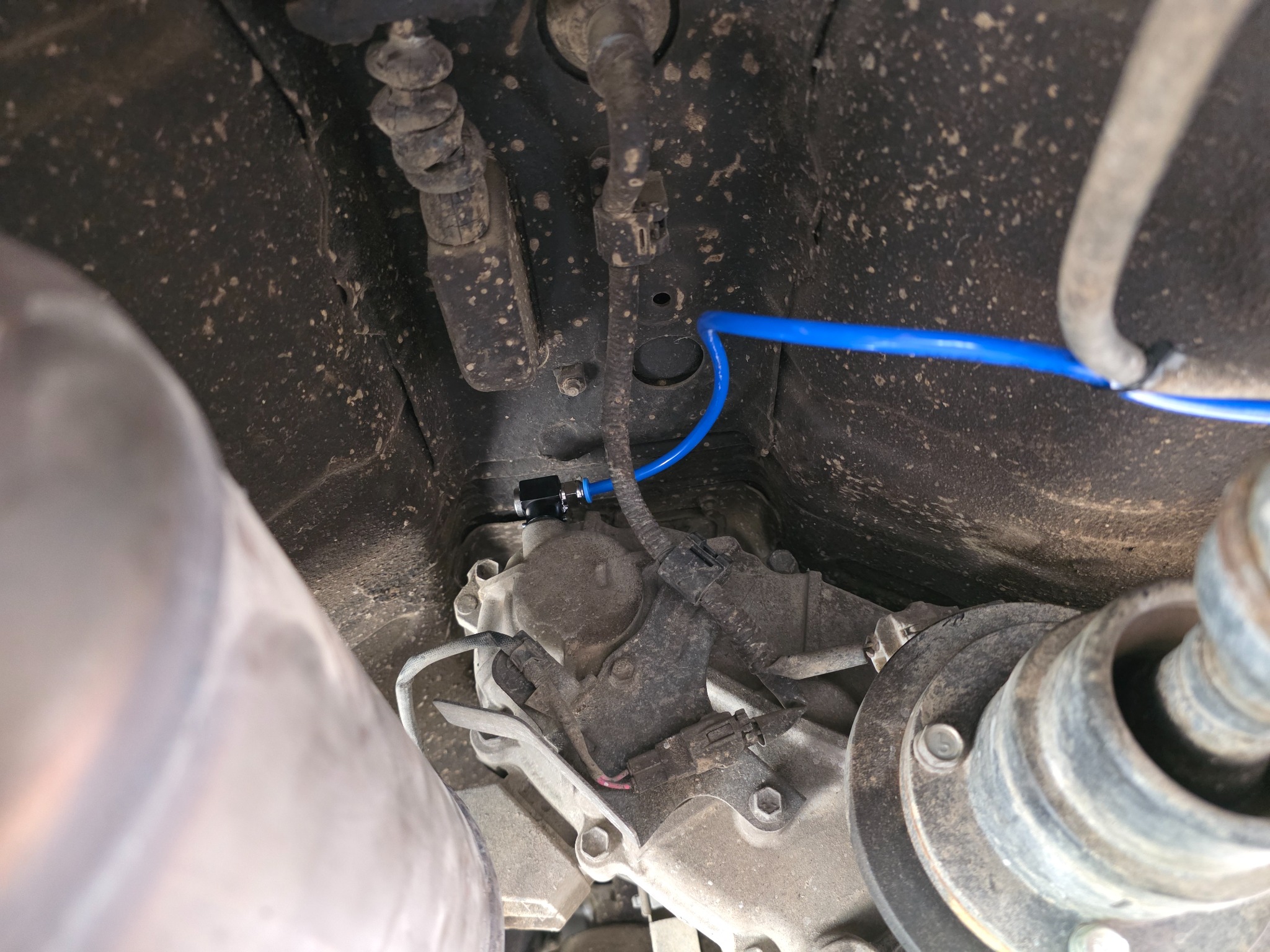

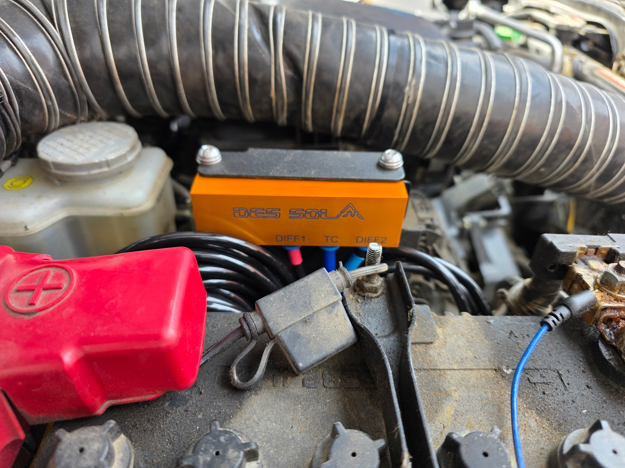

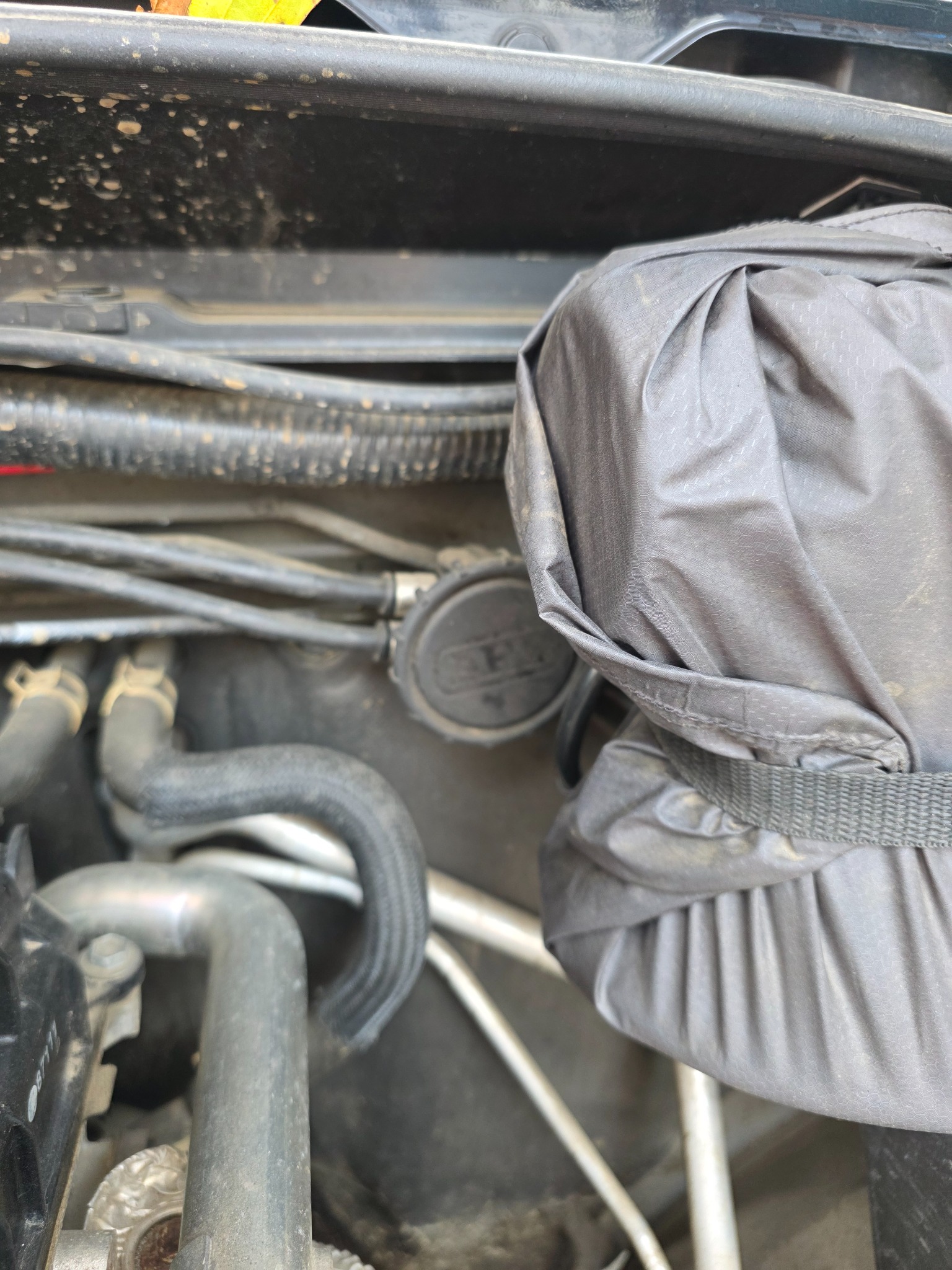

Yesterday I fitted the Des Sol transfer case breather (how long have I had it @DrRobin )
I've had diff breathers for years, using and ARB DIY kit. But never managed to do the transfer case due to the limited space. Then Des Sol brought thses out.
I had to buy new pipe as the supplied one had a major kink in it, and would have made the breather severely asthmatic. So I got blue to identify it.
I was just going to reroute the diff breathers to the new filter block from the ARB one, but that uses 8mm o/d pipe, the Des-Sol is 6mm pipe. At some point I will replace the 8mm with the 6 and remove the ARB filter block.
